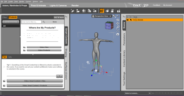

    Here's what I see.
    1360 x 711 - 112K
    Did you try changing to another layout? What sort of video card do you have?

    Alright, I've found out why the text in the box is glitchy-looking. When I click the arrow that controls the box containing the Tips, Info, and Tags buttons and everything below it, the text will squish itself to make room for the box or expand to normal if I'm clicking the arrow to hide the box. That problem is solved.

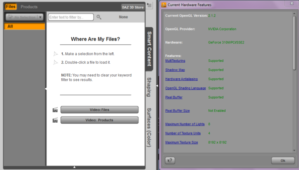

    What still isn't solved though is my "All" button showing no products at all. I tried applying a new layout and switching back, it didn't fix anything. I have made sure I have nothing in the scene selected, so shouldn't it be showing all of my content? I don't have too many things installed yet, but I have several creatures like a dinosaur, a wyvern, a troll, some toon animals, and others. Even if they are standalone products with no other content to go with them, shouldn't the Smart Content "All" tab be pulling them up in a list? For both the Files and Products tabs, the All button pulls up blank grey space, as if I don't have a single product or file installed. It's not a visual glitch either, because I've hovered my mouse inside and tried clicking to see if maybe it was just invisible, but nothing happens.
    I have looked for the content manager process in the All Users processes tab, and I don't see it running. I have the DAZ studio running when I look for it.
    I have the "About my video card" window open with the specs on the screen in this screenshot, in addition to my All tab showing zero files.
    982 x 558 - 56K
    Your video card specs look fine to me, and should work correctly.
    CMS controls what he Smart Content pane displays, and the Products and Categories options as well. Did you try to start CMS from Start > All Programs > DAZ 3D? If it starts and quits again when DAZ Studio is run, then you may need to uninstall it from the All Programs > DAZ 3D menu, and reinstall DS4.6, I take it that is what you are using, the latest version?
    If all of that doesn't work, it may be a corrupted database file, but try to restart CMS, and if that fails, uninstall it, then reinstall DAZ Studio to get the latest version of CMS installed.
