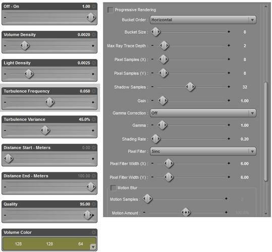

    ok I tried your settings, except that I turned the quality slider to 80, I think that's the step you're missing
    1024 x 768 - 336K
    Post edited by Rareth on

    I always use raytraced shadows, shadow bias is at 0.1
    render settings shadow samples are 32
    Shading Rate is 0.2
    if your light is too bright and or your Light Density in volume camera is too high, the effect your looking for can get washed out,
    I did another render in the one the spot light is behind the figure and the camera is in front, along with another spot light just to provide some detail, Volume camera and render settings also posted.
    731 x 678 - 103K
    1024 x 768 - 243K
