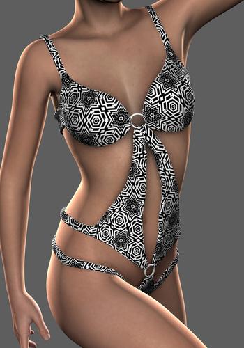

    I would like to do some kind of Morph to fix the ring on the top bra
    as you can see on the top it is a little bit streched out ..
    And I want to fix that ?
    But I don´t what is need for ?
    Do I need a JCM , my I dea was making a Morph just for the Ring ..
    But´i don´t know how to set it up in ERC ,
    Or should I do just a Visible DIAL to fix it ?
    Thanks a lot

  • Richard HaseltineRichard Haseltine Posts: 111,992
    You could make a correction morph and dial it in manually - that way it would be useful with multiple morphs that stretched the ring.
  • bloodboybloodboy Posts: 68
    Ah allright am I understand right
    I Export my cloth in this state,
    Make THE correction Morph
    And get it back to through MorphLoader
    And Use Deltas Only to setup THE Correction Morph?
    Or do i have to do ERC as well ??
    To make a new correction morph you would want reverse deformations on, to subtract the effect of the posing and morphing, and to make the morph unique.
    Allright but can I do a Morph that only effects the Ring ?
    And not the whole body ?
    Yes, any morph will affect only the parts that are moved in the morph - a morph is just a list of changed positions compared with the base mesh, which can be added to other changes from other morphs.
    I think I understand thanks a lot
