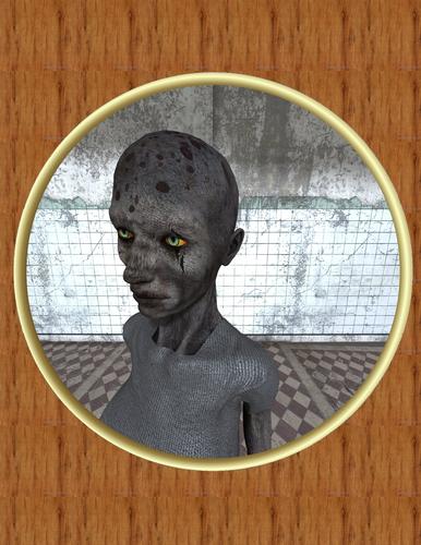

    You can get a quick and dirty fish eye lens by turning down the focal length. Here I have it set to 10
    1483 x 1920 - 666K
  • whispers65whispers65 Posts: 1,034
    Hey thanks! Actually for what I want to do something like that will work fine.

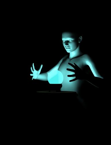

    Just tossed this together in DS4.6 to show a Uber Area light at work. Only one light and its the Crystal Ball.
    500 x 650 - 36K

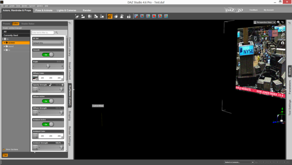

    Jaderail said:
    1. Use the Uber Area Base on the Screen of the TV, add the Image you like to the Diffuse Channel of the Screen set to 100% white and Again to the Ambient Channel of the Screen also set to 100% white and full strength. For the Uber Area Light setting RAMP the strength VERY high and ONLY touch the Falloff END and not the Falloff Start.
    okie thanks. I tried it. I'm sure I'm doing something wrong still. In the one pic, it shows the image set on the screen under the Diffuse Channel.
    This particular TV has it divided into TV, Stand, and Screen. I put the Uber Area Base on the Screen by select the screen in the surfaces tab and the CTRL clicking and ignoring changing the textures. I then put the picture on the Diffuse channel under the screen as shown. I turned on Ambient and set it to white also. I then adjust the intensity to like 200 and then changed the samples to 128 to eliminate the graininess on the first attempt.
    But no picture on the Tube. Maybe the TV is broken. :(
    1387 x 915 - 277K
    1920 x 1080 - 533K
  • ArkathanArkathan Posts: 66
    D'oh! Thanks Pete!
  • SzarkSzark Posts: 10,634
    whispers65 put the diffuse map (texture) in to the Ambient Colour Channel and try again. Also lower the Ambient Strength to 100%. TV screnn don't glow that much. :)
