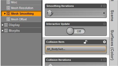

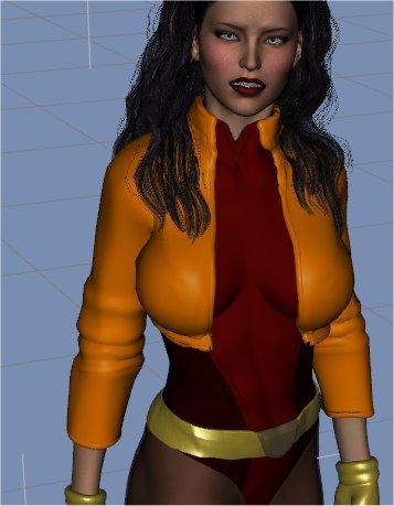

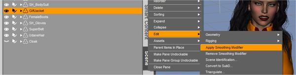

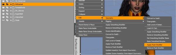

    This is how I do it, and please someone correct me if I am wrong. Edit: (Images appeared in reverse order sorry)
    In this example I have a jacket fit to the Genesis figure who is wearing Smay's super hero suit for Gen 2 Female (image 5)
    You want to go to the scene tab then the button on the top right corner go to edit and Apply the Smoothing Modifier to the clothing item you have fit to the Genesis figure (image 4) Then go to the Parameters tab and change the Collision Item to the clothing item under the clothing not the genesis figure (image3)
    If this does not do it fully you can adjust the smoothing and collision iterations or you can do a couple more things to help to make it fit, adjust the scale or even adding a push modifier (image2) go to the scene tab and click the top right hand button of the scene window agian and click edit, Geometry, add push modifier, now it will look bulky and fat, but go into the parameter tab and adjust it to fit it better.
    Under the Parameter tab go to Mesh Offset and set the offset distance to .50 or even .30 (Image 1)
    The default is 1 and is usually too much.
