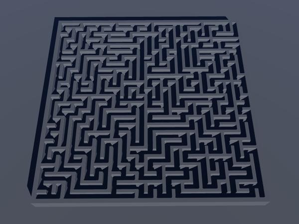

I made this maze
But it's made of a bunch of cubes.
Is there a way to like...weld to corners together to make them into 1 object?

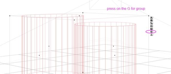

    Hold down the shift key click on each one and group them...or press your left mouse button hold it to draw a square around the items you wish to group and press the G

    Can I place this Maze onto a flat plane?
    Only problem I seem to have with Bryce is that...you can't edit a flat ground
  • Fencepost52Fencepost52 Posts: 513
    This is something I threw together in about 5 minutes. Is that what you're after?
    800 x 600 - 190K
  • assmonkeyassmonkey Posts: 0
    Yeah, something like that
    Guess I would need to make my own entrance
    Sort of wonder if you can even solve that?
