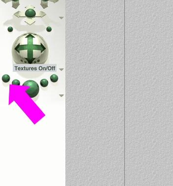

For example there is a button here that turns the rendering of textures on and off. Have you inadvertently disabled textures in the render engine?
Note that the final render will NOT match the Texture Shaded preview. The preview is just a way to get a rough idea of what the scene will look like prior to doing an actual render.
