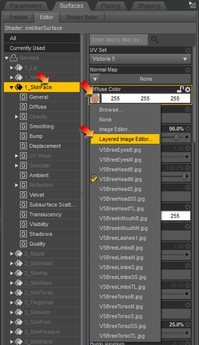

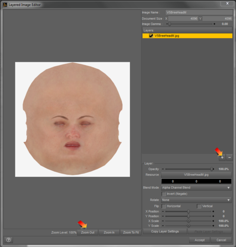

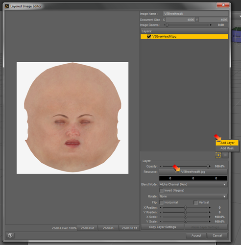

    I'll give a semi walk through for you.....
    1. In the Surfaces tab Pick a texture and the little Square of the Image in Diffuse then LIE.
    2. Zoom out until you see the full texture in the LIE and then click the +
    3. Add a new layer, Select the New layer then BROWSE to the one you want to overlay.
    Tada, now do this till done with all sections. Is not fun or easy but works. Do Test renders as you go only a full 3Delight render will show the full effects.
    OPPS Image 2 and 3 are reversed. So please note that.
