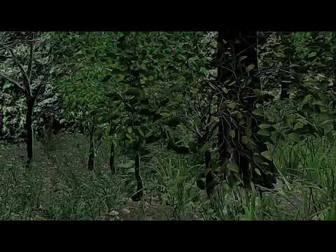

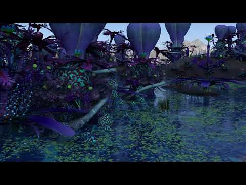

    just adding, I have found it surprisingly light on resources as opposed to the original yes
    my gripes about DAZ studio itself notwithstanding I was able to render populated terrains quite easily in both iray and 3Delight
    below heavily postworked and slomovideo processed render, because it is DAZ studio after all and regardless of what I use I cannot get the render speeds I am used to in Carrara devil that is nothing to do with Ultrascatter cheeky
    and a slideshow of another scene
