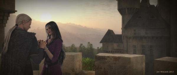

Everyday I'm learning more about this great program thanks to loads of the great advice I've received on this forum. I was wondering how best to render hair? I've included a new pic that I did over the weekend to highlight my question better. The sea nymph hair renders brilliantly but the hair on the guy looks a little average in my opinion.
To be honest I know nothing about shaders and the best way to render hair so was wondering if someone could give me some pointers?

    Hi, Jay! That's a really nice image, though I agree with you on the hair. What did you use to render it? Different programs and render engines handle materials very differently, so it would be helpful to know that before offering any advice.

    Thank you for the kind comments and for taking the time to read my post. I actually rendered the figures in Daz (3Delight) with one Uberlight, one Directional light to simulate the sun and two Alpha light planes to cast some 'fill' lighting to the scene. Rendered at 3000 pixels wide.
    The background was done in Vue and then comped it all together after.

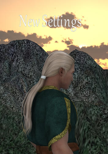

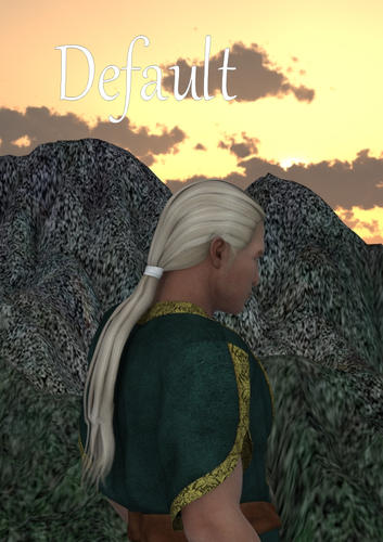

    I played around with PH Sleek settings a bit this evening. I changed the following attributes.
    Specular - Removed the specular map from the Specular Strength, Changed Glossiness from 50% to 40%
    Ambient - Changed Ambient Strength from 0% to 100%
    Opacity - Changed Opacity Strength from 100% to 75%
    Bump - Changed Bump Strength from 10% to 100%, Changed Negative Bump from -0.10 to-0.25, Changed Positive Bump from 0.10 to 0.25
    General - Changed from Plastic to Skin
    The renders below show default settings and the new settings. I was using Lantios Uberlights. Based upon my experiments the opacity of the hair was what really did the trick when you weren't in a close up shot. It softens the edges of the hair strands. I also used a specular spot that shines on the subject to give the hair some life. If you wanted the more platinum look using the new settings then change the ambient from 0 0 0 to a dark grey like a 54 54 54.
    Thanks for asking the question. When I first was playing with the hair I was so disappointed in the result I was getting. So I just put it on the shelf. Your question made me remember that I really like this style and that I needed to see if I could fix the problems I was having with the package. I really like what I got.

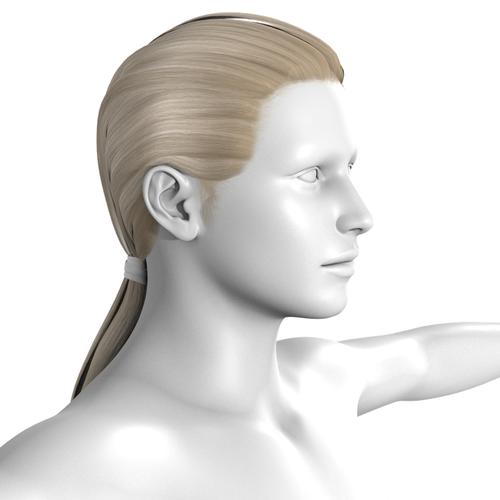

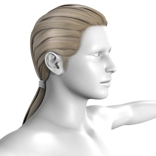

    Resurrecting this thread in order to add another option...I've been researching/experimenting with using the UberSurface shader on hair and came across some really nice settings by jamminwolfie of DeviantArt (also a vendor at Renderosity). I tested them on the Pure Hair: Sleek product and got some good results. The presets are available as a free download here.
    Below you can see a render of the hair with the Platinum color in its default state, and with the Shiny preset applied. The lights and scene are those that come with various hairstyles by AprilYSH (I though it would be a good test scene for hair).
    800 x 800 - 171K
    800 x 800 - 174K
