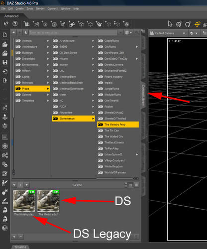

Good so you sound like you know what you are doing which is nice to see.
My Ministy DS formats show up in the Content Library Pane (Not Smart Content Pane) under Daz Studio Formats > My Library > Props > Stonemason > as shown below.
