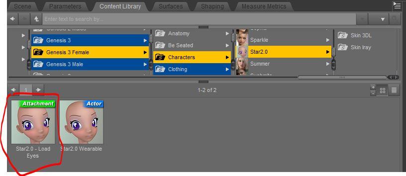

    How did you load Star 2.0? There's a character preset that should load fine.
    If you loaded here through "G3F-->Shaping Tab-->Star 2.0", make sure that you are using the "Star 2.0 Load Eyes" Attachment. This will replace the regular eyes with the anime eyes and a special eye socket.

  • chriswongbizchriswongbiz Posts: 223
    I did.  I first loaded Star 2.0 in G3F, and then loaded anime eyes, and then Star 2.0 default skin.  And that is the result I got, with socket deeper than it should locate.
  • BeeMKayBeeMKay Posts: 7,019
    If you already loaded the Star figure itself, you don't need the eye set, as it loads with the figure. Please check in the scene tab if your Star has two eye sets loaded?
    you only need to load the eyes when you load plain G3F.
