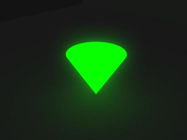

    Why anything glows? As it can be a PITA to use and depending on the mesh can give you really bad shadows. Simple enough to use the glow channel in the textures.
    Here is a quicky using the glow channel in the shader, the aura after effect; set very low, and rendering with full ambient.

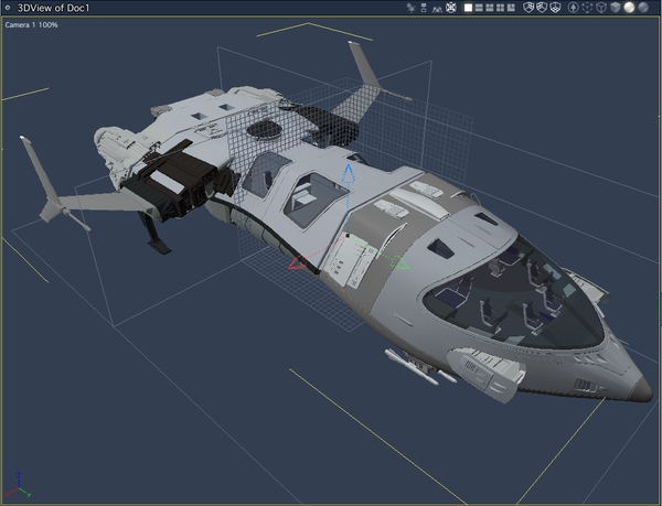

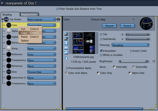

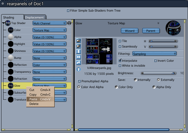

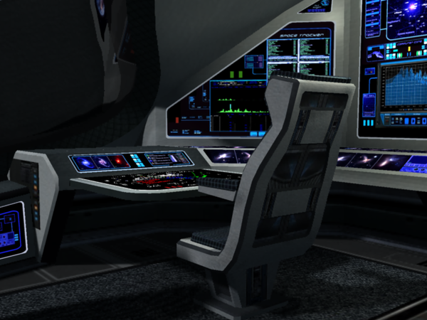

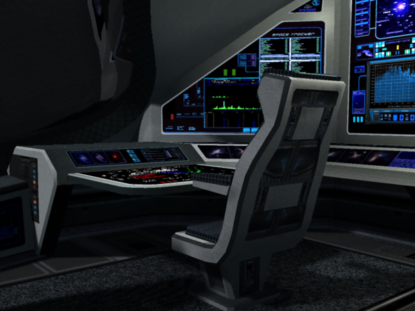

    The thing to remember is that Carrara, Poser, D/S, Lightwave, Blender, etc. etc. etc. all use different shading engines. When you bring in a model or scene with shaders designed for Poser, Carrara translates that information. Since Poser has functions that are a bit different than Carraras' and Carrara has functions that are different than Poser, some of it gets lost in the translation. The highlight and shininess are a good example areas that will need adjustment. The same with glow effects and sometimes alphas.
    A great example of what I was talking about in my previous post is the Vanguard space ship sold here at DAZ. When loaded directly into Carrara, none of the monitors appeared lit. The image maps were there in the color channel of the shader, but no glow. I copied the image maps for the monitors from the color channel and pasted them into the glow channel.

    I used a simple method to fix the issue, but depending on the effect the scene uses, there may be alpha maps (trans maps) and such that didn't load as well, so I would recommend looking in the textures folder to see if any other maps didn't load.
