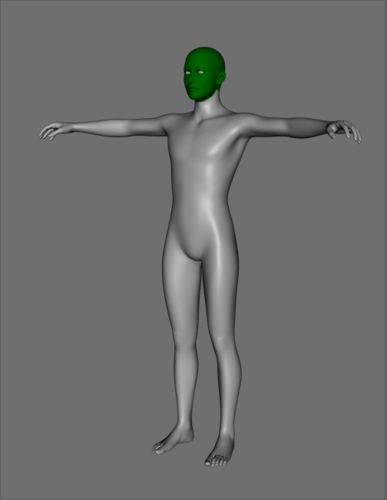

I m running into a problem that's driving me crazy and I can't figure it out. Basically I have a genesis model that is used as a cutout filter. For that I have marked certain areas of the body with certain solid colors. I followed some tutorial which said to set specular and diffuse to 0, and amp the ambient to 100% and then assign ambient colors. And that works fine if I use the lowest quality rendering setting (I think that's software render or something) in DAZ3D 4.6. For the example refer to pic 1 - you can see how body is in solid white, head is in solid green.

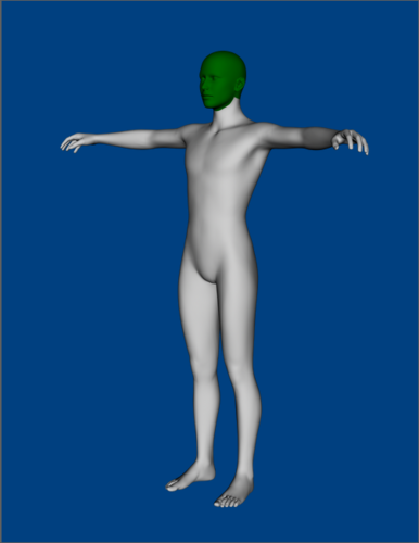

The problem starts when I try to use the high quality render feature (3Delight) - that's when the whole model suddenly turns black. (picture 2) with green eyes. Does anyone have any ideas what could be causing this. No settings between two images were changed, only the bar on the render quality window being raised from 1 to 4

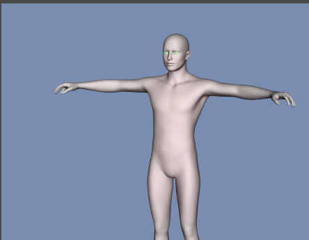

    Hm, that makes sense, but when I tried it , it just ended up rendering the whole thing in gray color with shading (as in the pic)....

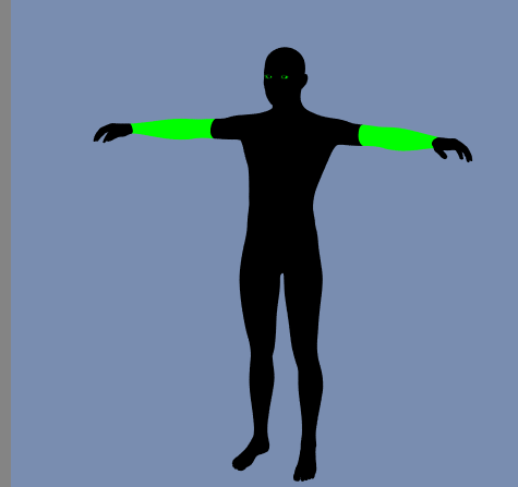

    For the Multi Zone Mat renders you wish to do there is NO reason to use the FULL 3Delight render engine unless you wish for the shading. If that is your goal only change the Diffuse in Surfaces Tab, then set to Matte as the Lighting Model in the Surfaces. This is what you get using the FULL render then.
    405 x 650 - 43K

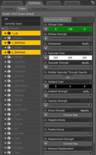

    Yup, it's shader related... I just looked at the genesis model and it had "Multiple" as shaders. Then I looked at each of the surfaces and all of them except the eyes had some "onHumanSurface" shader. Eyes had dazDefault (and they are also the only thing in the original picture that actually had green color). If i change arms to dazDefault for example I can then get arms rendered in green , as the picture shows.
    Unfortunately it doesn't seem I can simply switch everything to dzDefault because there again seems to be slight diff in generated pixels in the final image, so if i try to run dzDefault rendered mask vs unmodified Genesis render the generated cutout is wrong. And if I try to render actual image with dzDefault I get some weird artifacts around legs (like texture seams or somethign like that). So I need to figure out why this onHumanSurface shader that makes it behave differently. Any ideas where to look for clues ?
