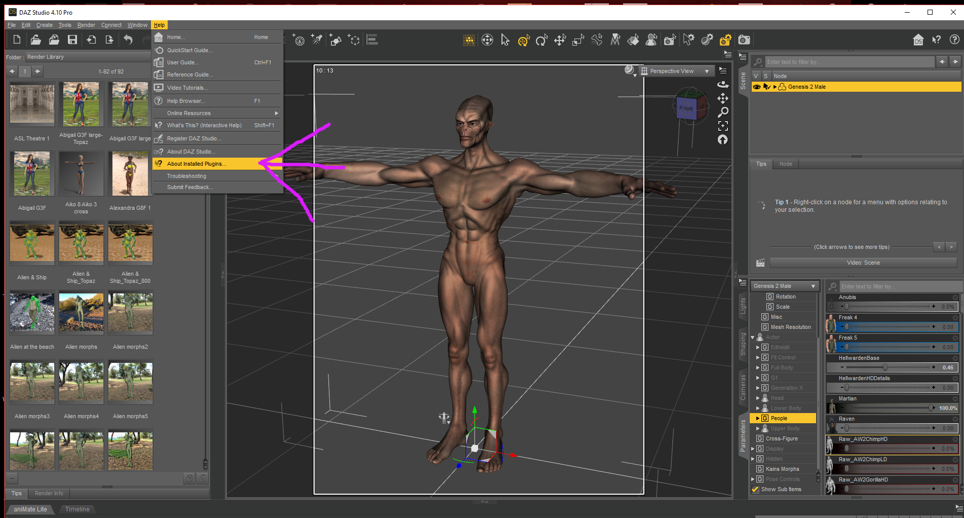

    Setup (I assume that you have done this bit but have included for newbies)
    In DAZ Studio click on the Help Tab, then click on About Installed Plugins
    In the About Installed Plugins pop-up, scroll down and make sure Genesis Generation X2 is ticked and has the green Loaded Status
    Click on the Window Tab, click on Panes (Tabs), then make sure GenX is selected

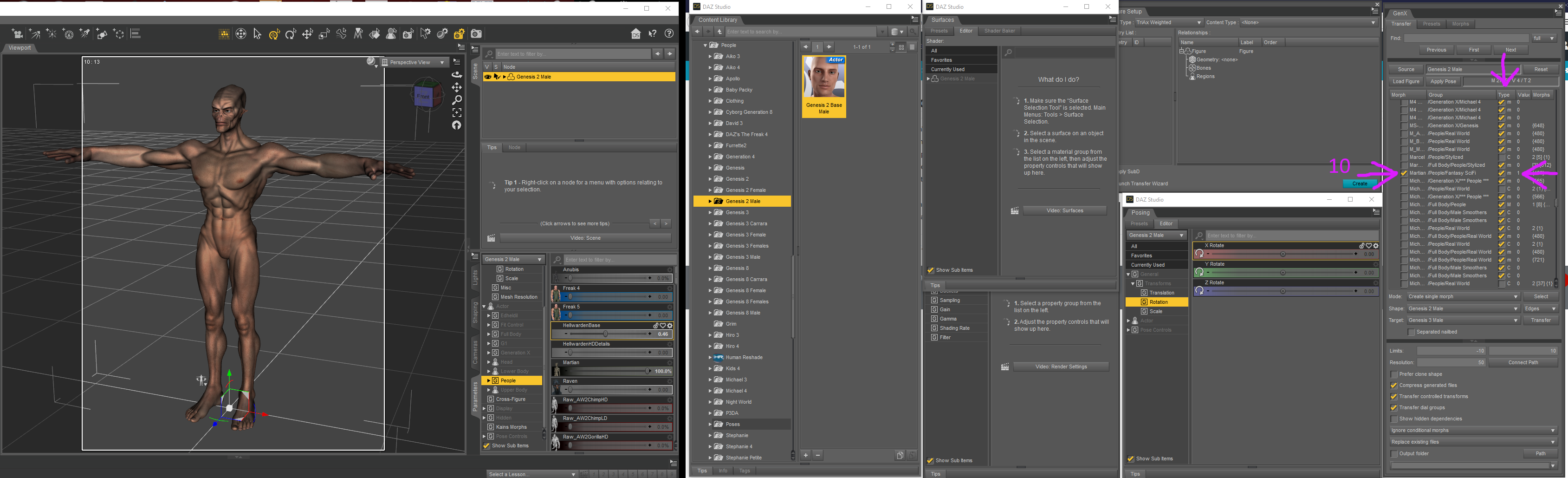

    1. Select your Genesis 2 figure and load it
    2. Select and dial in the morphs you want to transfer in the Parameters Tab
    3. In your GenX Tab, click on the Source button
    4. Select your Genesis 2 figure (note depending on how many morphs the figure has this could take a little while)

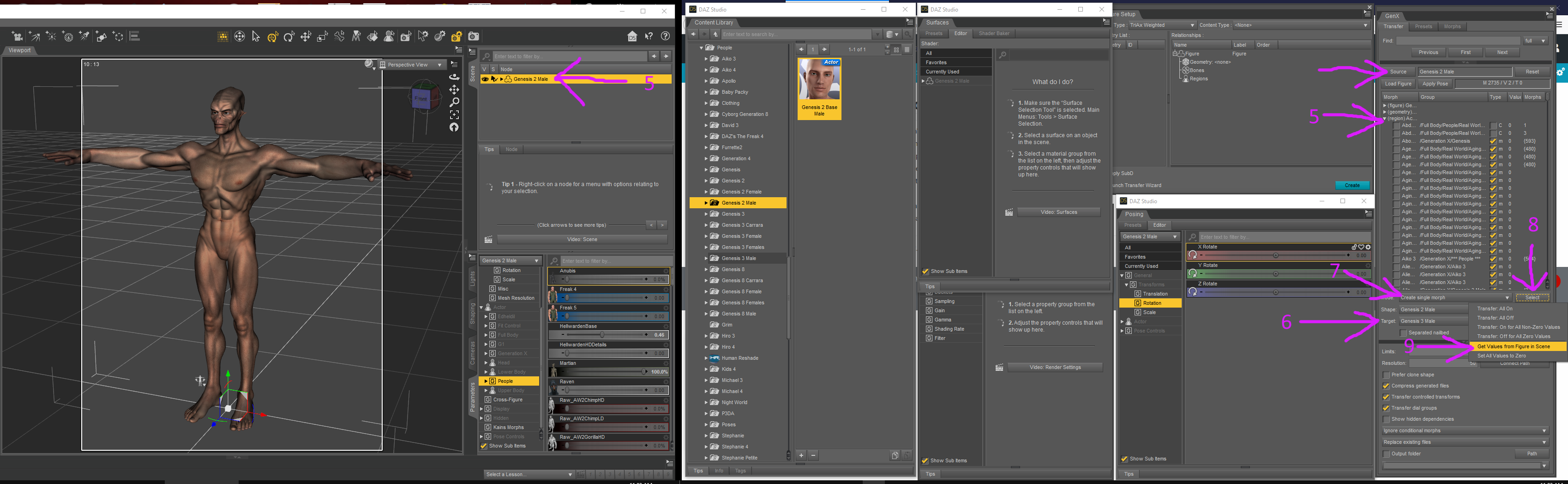

    5a Make sure your Genesis figure is selected
    5b Once the values are transferred from the Figure in the Scene (Step 9) you will need to locate the morphs (Step 10)
    6 Select your Target figure, Genesis 3
    7 Select Create a single morph (check out the other options if you need them.
    8 Click on the Select button
    9 Click on Get Values from Figure in Scene
    10 First of all you will need to find which Morph to look in, I normally start with Actor. Look down the Morph list to find the name of the morph you dialled in, it should have a non-zero figure in the Value list. Tick the morph when you find it.

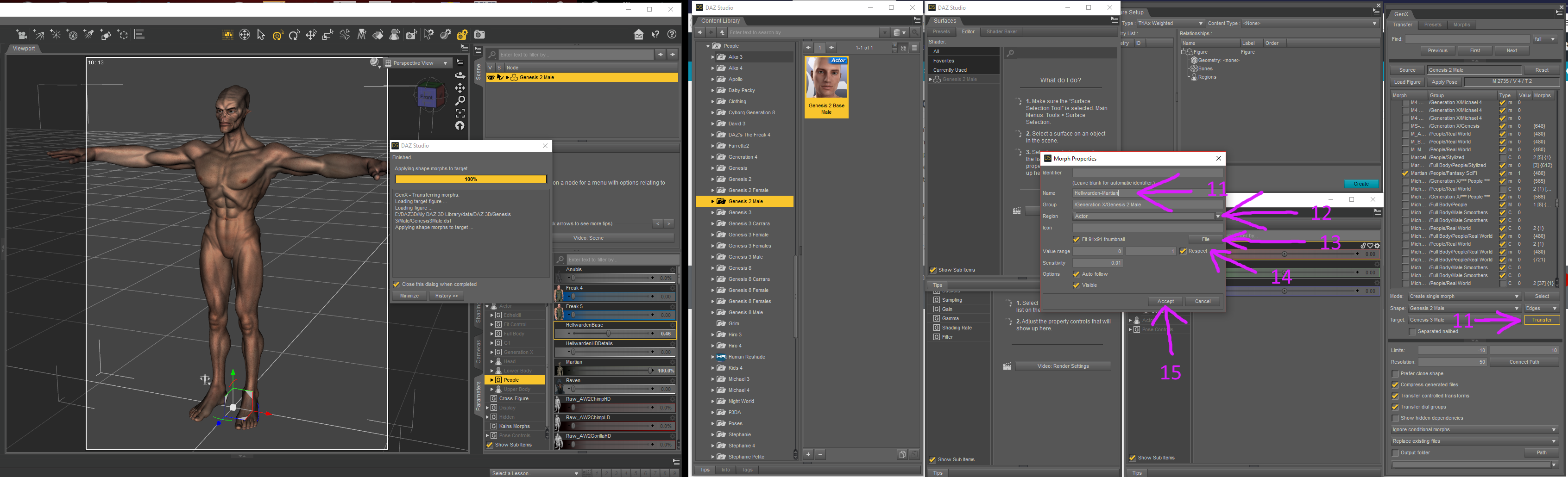

    11a Click on the Transfer button
    11b If all is okay you should get two pop-ups, one telling you Finished. Applying morphs to target. Second pop-up is the Morph Properties, enter name for your new morph.
    12 Select which region the morph is being applied to. Click on the down pointing arrow for options.
    13 If you have an icon, click on File to locate it.
    14 Adjust the Value range if required
    15 Click on Accept
