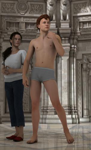

  • Scott LivingstonScott Livingston Posts: 4,352
    I ran into this issue with the attached image. Doesn't seem right to me...I think the reflections in the floor should be blurrier (think of the distance the light is traveling between the floor and the objects being reflected). Unfortunately I don't know what the solution is...just thought I'd post the image as an example.
    Googled "Reflections and depth of field" and found the following article, which appears relevant, though the software is Lightwave: http://www.altyna.com/lw/DOFreflections.htm
