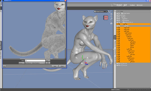

I'm currently hybridizing a couple of Daz figures to create a Neko. (see attached screenshot) It's essentially Genesis with monster morphs, with an attached Mil Big Cat tail. It works great, but I'd like to trim down all the hidden parts that I don't need - which is everything but the Big Cat tail. Is there a way to unparent the tail from this figure?

    The tail isn't a child object of the milcat so it can't be unparented. The parent child relationship between two separate objects is different than the parent child relationship between two bones in the skeleton of a figure. The former can be separated, the latter cannot. The tail bone is a child of the hip, but there isn't a way to separate the tail from the rest of the cat within DAZ Studio. To do that you would need a modelling program like Carrara, Hexagon, Blender, Maya, Modo, Max, or any other modelling program of your choice.

    Yea, I don't conform the tail with Genesis. I use Z translate to push that patch into the body, then the Y translate to place it more towards the tail bone then parent to the pelvis. I've tried actually using autofit on the tail, which looks ok at first, but when you go to pose Genesis, the resulting tail isn't very pretty. o_O

    Yea, I don't conform the tail with Genesis. I use Z translate to push that patch into the body, then the Y translate to place it more towards the tail bone then parent to the pelvis. I've tried actually using autofit on the tail, which looks ok at first, but when you go to pose Genesis, the resulting tail isn't very pretty. o_OYeah...autofit doesn't work well with items that aren't close to the body. I remember reading something in Blondies advanced rigging tutorial IIRC either that or a thread that the weight mapping is linked to the wrong part or something similar.
    I only know when I autofit anything that sticks out the posing will be difficult. I can normally get it to look good in zero pose but when I try to pose it stuffs up.
