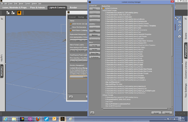

    Where is your content folder, and what is your operating system? Can you go to Edit>Preferences>Directories>Content Directory Manager, expand both the "DS Formats" and "Poser Formats" sections, and post a screenshot?
  • galattgalatt Posts: 229
    Sorry, forgot to add that.
    I'm using Windows 8 64 bit 16 Gb of ram
    1366 x 886 - 178K
  • fixmypcmikefixmypcmike Posts: 19,707
    You shouldn't have all the subfolders of My Library listed -- that could be the reason files aren't being found.

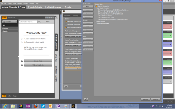

    I clear out all the others that it looks like the attached, but the items still aren't showing up.
    Do I need to reset the database, then re-import all the metadata files?
    1450 x 912 - 149K
    You have nothing selected!
    Click on All or Default, and you will see the word 'Searching...' to the right of the search box.
