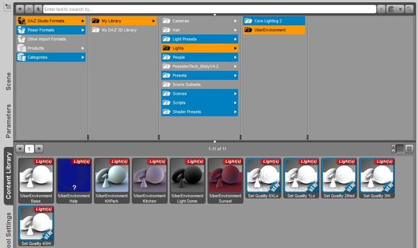

    A very quick 'get you up and running' reply!
    a) Load the !UberEnvironment Base (top left in your content library. This will load the basic light environment which we can later adjust
    a.1) Before performing b) or c) ensure you have the UberEnvironemt prop selected in scene tab.
    b) Load a 'preset' to modify how the environmental lights will work (that will be one of the 4 coloured icons in your content library (top row, 3rd from left to 6th from left). They will adjust the overall colour and lighting levels.
    c) You can adjust the quality of the final lighting model with one of the 5 remaining icons (which are white and have a name starting with 'Set Quality'). Be aware that low quality renders will be quicker but will have significant blotching in renders, and that high quality will take a fair bit longer but will, naturally, be of better quality!
    d) And that is that.
    e) To be honest, you really need at least one more 'main' light - I tend to think of the UberEnvironment as providing the global illumination (the effect of light bouncing off of object and thus coming from all angles) and add a Distant light to act as the sun (and also another Distantlight parented to the sun light set to just privide Specular lighting).
    Once you have a basic setup you can play with it and see what effects it will provide for you.

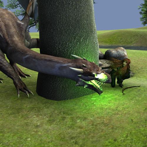

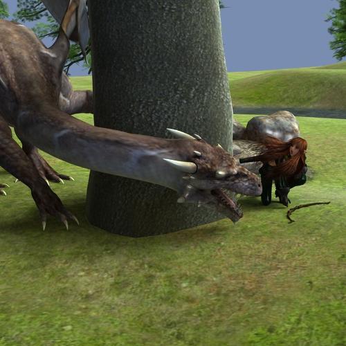

    I am glad also this topic has been raised. For me it seems lighting is a challenge for my renders. I try to implement three point lighting. Most of my renders using the regular lights render out more darker than it appears in the viewport at design time. I loaded up a scene I did call Dragon Sneak and took out all regular lights I had placed and decided to try UE2. I have heard of it but never really found where it was until reading this thread. So checked out the youtube video and setup UE2 light very close to the dragon and the character. You can tell how close by judging the shadows near and below dragon and character. I then placed a spot light very close but put it on specular only. I am not sure I can see any specular impact or what it is suppose look like. It does seem UE2 renders with more light than the regular lights. This render differs from my others using the same scene and regular lights.
    Products used in Render
    Forest Bundle
    Victoria 4.2 Base
    Victoria morphs ++
    Aiko 4
    Barliecorn
    Aspasia Hair
    V4 Archer
    500 x 500 - 186K

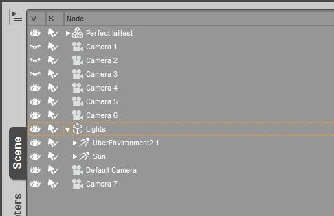

    Just one thing to remember with UE2 http://www.daz3d.com/forums/discussion/18998/
    And the OP's screenshot shows UE not UE2. UE2 will be under Light Presets, not Lights.

    ... setup UE2 light very close to the dragon and the character. You can tell how close by judging the shadows near and below dragon and character.
    The location of the UE light doesn't matter, as with a distant light only the rotation has any effect.

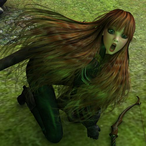

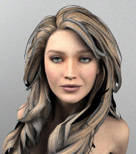

    Sort of off-topic, but why is luxrender turning the blonde hair blue? I was told by a photographer friend of mine that blonde hair is the most sensitive to colour change due to light sources.....but blue? really? :(
    I didnt want to waste any more time rendering, so just posted the wip
    626 x 708 - 225K
    Post edited by derekmccaughey2010_a63ad0a6ab on
    You might have blue as a specular highlight colour, and it also appears that your opacity maps may not be working correctly. Did you let Luxus do the conversion for you or did you manually input the settings for the materials? My personal preference for hair is as follows:

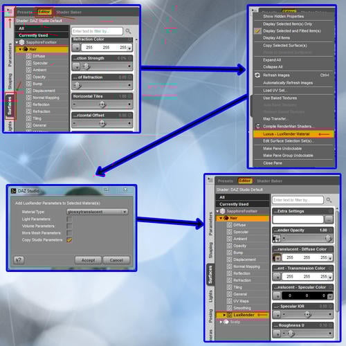

    Opacity maps tell the render engine which parts of a model should be invisible. They're very common on things like hair, as it's easier to simply texture individual hairs than it is to model them. That said, knowing how to change Luxus defaults is probably one of the most important aspects of using Luxrender, so here's the basics.
    In the Surfaces tab click "Editor" so you can see all of the individual settings that make up a material. In a corner you'll see an icon with three horizontal likes and a triangle pointing to the right. This is a contextual menu and gives additional options. Select a surface then click the contextual menu button and scroll down to Luxus - Luxrender Material. Here you'll get a window allowing you to select what sort of material you want to change the current surface into. Here I've chosen glossytranslucent.
    After that if you expand the material setting you'll see a new option which says 'Luxrender'. Click this to see all of the properties which are exclusive to Luxrender.
    Incidentally, this same contextual menu is how you can create Luxrender lights. Make sure you're on the Parameters tab first and then click the contextual menu to select Luxus - Luxrender Light. Many need a parent entity, so I tend to use nulls for this.

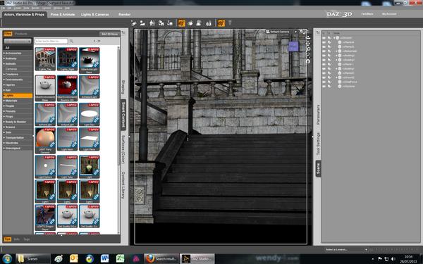

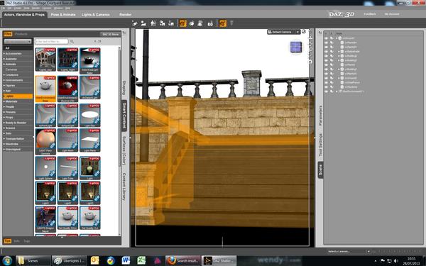

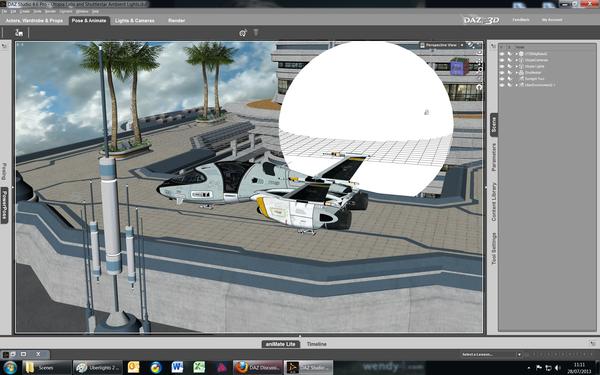

    I have a strange problem when using the Uberenvironment 2 with Stonemason's Village Courtyard scene. As shown in the two jpegs below, when I click on the appropriate preset, the lights kick in but part of the village vanishes. When I delete the lights from the scene tab, the village pops back in all its glory.
    Any suggestions?
    Alex.
    1920 x 1200 - 552K
    1920 x 1200 - 653K
    What you are seeing is the UberEnvironment sphere. It's only there as a visual aid when using image based lights and won't be rendered in the final image. Your scenery hasn't gone anywhere.
  • alexhcowleyalexhcowley Posts: 2,411
    Thanks for your fast response. Isn't this going to get in the way when I start adding figures to the balconies?
    I've since tried adding uberenvironment 2 to Jack Tomalin's Invetero and Stonemason's Utopia Labs. I had no problems with white spheres when using Invetero but the sphere appears on Utopia Labs.
    Cheers,
    Alex.
    1920 x 1200 - 653K
    You can hide the sphere with no detriment to the final render, as it's merely there as a guide. Expand the UberEnvironment in the scene tab and click the eye icon to hide only the sphere.
