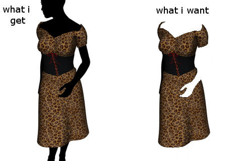

in my spare time, as well as doing conventional image-making, i also make home-brew games, usually sprite-based
one thing i've long wanted to be able to do, quickly and easily, is to create overlays of things like clothing items. these could then be used to clothe in-game sprites
at present i do this as follows:
1) create an all-black figure (v4 or m4)
2) clothe it with an outfit, and pose it appropriately
3) render
4) i now have a black clothed figure. in the gimp i select the black areas and cut them out
that kinda works, but the selection process is not accurate, you always get a degree of bleed-out, especially for dark clothes, and it almost always requires a degree of manual fudging. for animated sprites that can involve a whole load of laborious effort, and the results are never entirely satisfactory
what i WANT to be able to do is to render the black figure as an alpha channel. so, it acts in the scene as a figure would be expected to do (i.e. hiding the back parts of clothing, or putting an arm in front of a dress, as in my attached example, and so on), but in the rendered frame there is a big fat transparent alpha channel in place of the black figure
any suggestions gratefully received

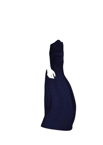

    The only way I got a really good mask was to use Surface Mask Creator form the DAZ3D store. Here is a thread about it working in DS4.5 . The below is what I did in DS4.6 latest public release.
    Mask made in Surface Mask Creator and applied in Photoshop
    707 x 1000 - 85K
    707 x 1000 - 28K

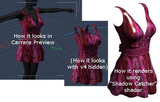

    and, just to prove it, here's a test render from carrara to demonstrate how it works in practise
    1) shows a v4 in one of her party frocks
    2) shows the same scene, with v4 simply hidden, and where you can obviously see the back bits of the dress
    3) after applying a shadow catcher to v4, and with "render alpha channel" on, and rendering to a .png file. it can be seen that the v4 object acts on the scene (to hide the back of the dress) but does not actually appear in the render itself. so, you end up with precisely the effect i was asking about in my initial post
    this is a tremendously useful feature. i only wish it were available in DS
