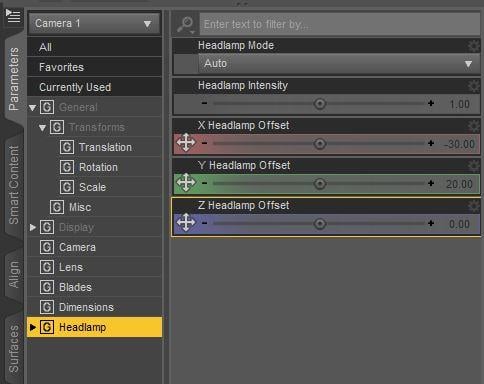

    The headlamp is offset from th camera, so when you zoom close enough the things in view are on the edge of, or even outside, the light.

    Unfortunately, there is no offset shown in the camera headlamp settings.  It makes complete sense that offset could be the cause, though.

    You should see something like this
    Parameters pane with headlamp settings
    484 x 384 - 36K
    That's exactly what I see.  :)
