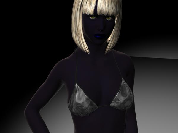

Awhile back I did up an image in DS2 utilizing the free jlg velvet shader. I'd forgotten that I used that particular shader and today when I opened up the setup to play with that particular figure for a new image, I realized that of course, DS4.5 can't use the jlg shader (it gives an error about recompiling which I can't do). My big problem is, the shader was used for a character's skin, rather then clothing, so I need to have the look be as close to the original as is possible. Is there anyone that can help me with this?
I've attached a screenshot of how the shader looks when rendered along with the settings it shows in case that helps any.

    a Quick test with the !Human Surface Base and I get something similar, colors need more tweaking I think

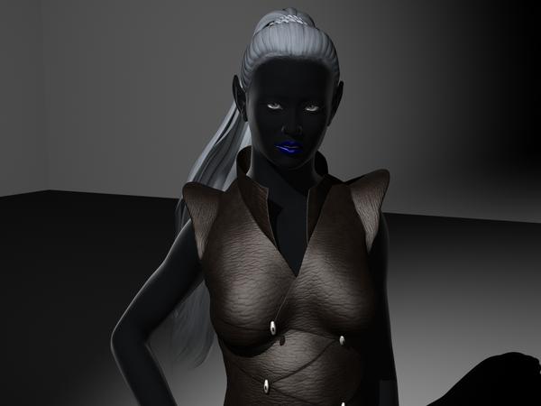

    ok this is with the !Human Surface Base
    see if this is what you are looking for.
    1024 x 768 - 259K

    That actually looks VERY close to what I have been trying to do.

    well here are the settings (ALL of them) so have a go at it
    Diffuse color 15,15,17
    Diffuse Active - on
    Diffuse strength 100%
    Diffuse roughness 1.00
    Opacity Strength 100% default
    Opacity Active - on
    Opacity Color 255,255,255
    Refraction Active - off
    Index of Refraction 1.3
    Smooth - on
    Angle 89.90
    Bump Active - on
    Bump Strength 100%
    Bump Minimum -0.10
    Bump Maximum 0.10
    Displacement Active - off
    Displacement Strength - 100%
    Displacement minimum -0.10
    Displacement maximum 0.10
    Trace Displacements - off
    Map Tiling U 1.00
    Map Tiling v 1.00
    Specular Active - on
    Specular Color 255,0,255
    Specular Strength 50%
    Glossiness 50%
    Specular Sharpness 0%
    Specular2 Active - off
    Specular2 Color (255,255,255)
    Specular2 Strength 100%
    Specular2 Roughness 10%
    Multiply Specular through Opacity - on
    Ambient Active - off
    Ambient Color 0,0,0
    Ambient Strength 0.0%
    Reflection Active - off
    Reflection mode - Environment Map
    Reflection Environment Map (Map in Lat/long format)
    255,255,255
    Reflection Color 255,255,255
    Reflection Strength 100%
    Reflection Blur 0.0
    Reflection blur Samples 4
    Multiply Reflection through Opacity - off
    Fresnel Active - off
    Fresnel Strength 100%
    Fresnel Fall off 0.40
    Fresnel Sharpness 0.0%
    Velvet Active - on
    Velvet Color 255,255,255
    Velvet Strength 50%
    Velvet Falloff - 20.0
    Subsurface Active - on
    Subsurface Color 255,128,255
    Subsurface Strength 100$
    Subsurface Refraction 1.5
    Subsurface scale 4.00
    Subsurface Group 0
    Subsurface Shading Rate 32.00
    Translucency Active - off
    Translucency Color 255,255,255
    Translucency Strength 100%
    Accept Shadows - On
