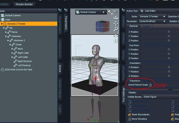

    at first,, unparent genesis ,
    then confrim genesis scale , then open joint editor, (you may need go to top menu>windows>tabs)
    select root genesis, and check off transform section "inherit paretn scale."
    after that parent genesis to anything you want. you can use , if you keep the translation, Parent in place
    or simply drug to the node. you can check off parent in place, then stuck to the node.
    and you can un-parent when you want to do.
    your clothing which fit to genesis, and genesis get no influence, form parent obj or node.
    but I do not know, save as scene.duf, can save the proeprty ( Inherit parent scale)
    of joint editor or not.if I may need to save modifed assets.

    if you hope to be not influenced from parent, simply select the objects or prop.
    then go to joint editor. and check off Inherit parent Scale.

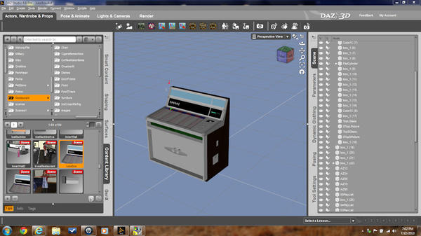

  • grpruettgrpruett Posts: 255
    The following two images is a Jukebox I created from an earlier version of DS 4 by only using primitive objects, and while creating it, I parented, I un-parented, I switch parents and I gave the parents parent (whichever I need at the time). So when I tell you that parenting is behaving differently in this version than it had in earlier version, I'm not talking out my ass. FYI, I tested the checking off the inherited parent scale in the joint editor and it creates and new set of problems when I'm trying to create my props from primitive objects.
