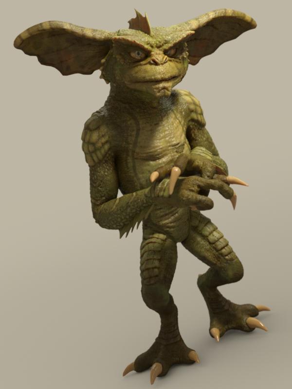

    Destiny's Garden and Diomede pretty much nailed it.  I just shove the mesh around in zbrush, load the morph in studio, adjust rig to shape, and then get to work making jcms for the things that don't bend right.
    Every once and a while I use HD (I went back and added it to Mr. Turtle when I updated him for Iray, it was essential to pulling off Mean Mr Pumpkin head, helps the snowman to be just a little more lumpy). Sometimes there are added conformers or smart props, like a carrot, ball nose or turtle shell, but I don't do geografts.  It's not through a devotion to the pure discipline of point pulling. I just can't get the grafts to take on my end, I'm always left with a gap.  Blondie and Sickleyield have tried to help me through it, but there's still something I'm just not doing right.
    Some of my personal favorites come from the first genesis figure.  Mr Turtle, Frogs, Mouse and Naked Mole Rat.
    And here's a genesis 8 morph that I can't sell (because it's a Gremlin), and I can't give away (because it uses Daz's proprietary HD technology).

    That Gremlin... D: Could you give it a slight enough alteration to get away with copyright? That seemed to be what Petipet's done with their Cylon Raider-alike. Give it a more human-like number fo figners or something like that?
    Or turn it into the G2 spider hybrid! Maybe an original scorpion version of that? :D

    Well the old Marvel Comics character called Triton that is a member of the Inhumans has some similarities to the bad Gremlins which isn't very different than the old logo for the car called Gremlin
    https://www.pinterest.com/pin/300826450101683081/?lp=true
    http://www.brandsoftheworld.com/logo/gremlin

    @JoeQuick...that gremlin is freaking awesome...and made it from a genesis 8 mesh at that....incredible!
