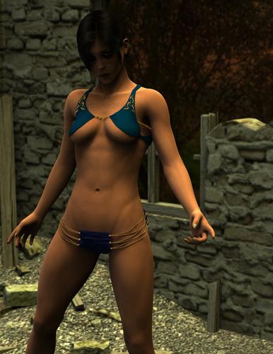

I thought I had this almost figured out, but if you noticed around the head,neck, and Chest .. something is not right, and I'm not sure how to correct it
using set HDR KHPark . . only change was the light color
Set Quaility 4XHi
I'm sure it's adjusting some settings in lighting, but no matter what I change it gets worse. I had to delete the UberEnviroment2 and do it all again, and with just the color adjustment this is the result
1000 x 1294 - 676K
Post edited by XaatXuun on
    Changing UE2 settings aren't enough, you need to also change the render settings. Try changing the shading rate to something like .2
  • XaatXuunXaatXuun Posts: 882
    yeah, that seemed to help, but I had changed the light, need to do this again, but with the light coming from a better angle, then what I did here.
    looks like it went away , still shows what I don't want, but not as bad
    1000 x 1294 - 714K

    As mentioned, shading rate and shadow samples are the two biggest contributions to the noise caused by UberEnvironment. Ideally you want shading rate to be fairly low. Many people including myself use shading rates of 1 or less, with myself using 0.1, one tenth. This will bump up render times somewhat but essentially means for every pixel you're getting multiple samples for the occlusion, so it's much smoother and removes the grain.

    tried it again with the changes to the render settings, but this old machine cannot handle the changes, and will crash on me . . I'll need to play with some different settings, or lighting.
