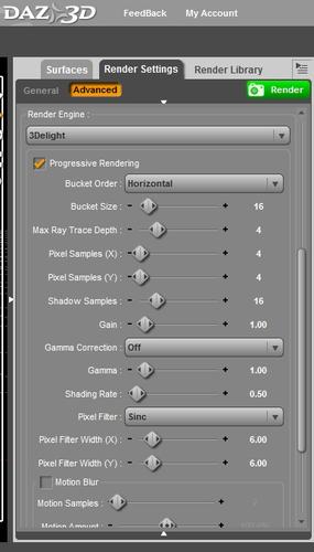

I have noticed an error message every time I render, just wondering how to fix the issue.
I do end up with a rendered image but it seems to take a long time and the image never matches the preview window.
Many times the preview has better detail and color than the render.
3Delight message #141 (severity 1) D2045: pixel filter reset to box

  • SerjLSerjL Posts: 1
    pleace
    1920 x 1080 - 340K

    Okay this is definitely related to Progressive Rendering and which settings I choose inside PR does not improve the outcome.
    If I turn off PR then it renders using SINC.
    So this bring up the question, what is the benefit of PR. Should I just leave it off? Will that effect the quality of final renders?

    Progressive rendering starts by rendering a crude version of the scene, then goes back and fills in a bit more fine detauil, then again and so on until it reaches the end point (what you would get without progressive rendering on). It's benefit is in letting you see the whole scene rendered quickly, if crudely, so that you can assess over-all composition, the way the light and shade are falling an so on, without having to wait for a full final render. There's no point in using it for final renders.

    Generally this happens if you are using the "Progressive Rendering" option checked in the Advanced Rendering tab. It can generally be ignored.

    Progressive vs non-progressive do things in a different way. So its not a matter of "good" vs "bad" its just a matter of different.

    The quality should be similar. If you're in 4.6.1..17 or later, which one is fastest depends on the complexity of your scene (progressive begins to beat standard as the amount of geometry increases). They both have the strengths and weaknesses so its situation dependent. If you want to read the specifics you can check out 3Delight's documentation. The progressive render is using the ray trace hidder, the non is using the hidden hider (Reyes).

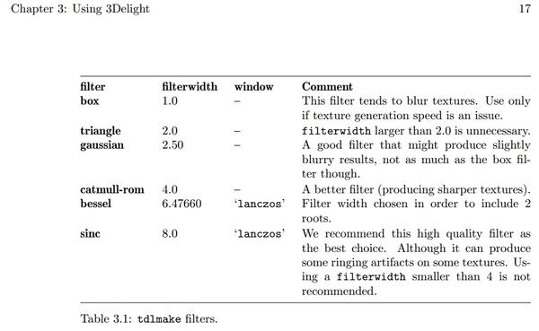

    Is this the documentation you mean?
    http://www.3delight.com/en/uploads/docs/3delight/3delight_39.html#SEC159
    http://www.3delight.com/en/uploads/docs/3delight/3delight_52.html#SEC205
    http://www.3delight.com/en/uploads/docs/3delight/3delight_12.html#SEC19

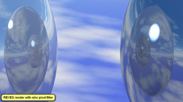

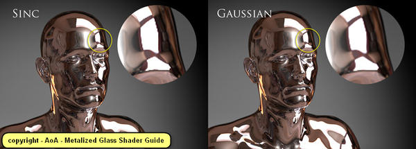

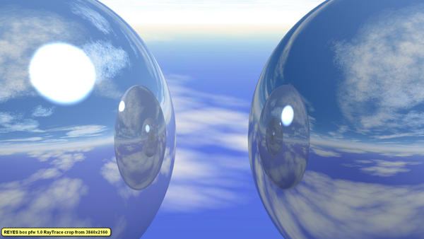

    If the Progressive Renderer is switching the Pixel Filter from SINC to BOX, then this seems to be an issue if you want to use progressive rendering. According to 3Delight:
    filter filterwidth window Comment
    box 1.0 - This filter tends to blur textures. Use only if texture generation speed is an issue.
    triangle 2.0 - `filterwidth' larger than 2.0 is unnecessary.
    gaussian 2.50 - A good filter that might produce slightly blurry results, not as much as the box filter though.
    catmull-rom 4.0 - A better filter (producing sharper textures).
    bessel 6.47660 `lanczos' Filter width chosen in order to include 2 roots.
    sinc 8.0 `lanczos' We recommend this high quality filter as the best choice. Although it can produce some ringing artifacts on some textures. Using a `filterwidth' smaller than 4 is not recommended.
    Table 3.1: tdlmake filters.
    From this table it seems Box makes a blurred version of the render compared to Sinc?
    I believe its these docs: 3delight Docs
    The pixel filter is not the same as the tdlmake filter.
    Post edited by DAZ_cjones on

    When I did a search for any explanation of the Pixel Filter settings it only came up with the 2 error codes D2045 and P1041.
    The point I am trying to clarify is that my renderer is generating an error code D2045 which indicates it changing the pixel filter from "sinc" to "box" when you do progressive rendering. Why is it doing that? Is pixel filtering used in non-progressive rendering (REYES)? The table I refered to explains the differences between filtering methods. Why would it not apply to pixel filtering equal to application in texture optimization?
    Table 3.1 is in reference to tdlmake filters would not the quality variance apply to the pixel filter too?
    tdlmake is just a command line texture optimizer that inputs image files and converts them to TIFF files optimized for the renderer.
    It seems the basic difference between Ray-Trace Hider (progressive renderering) and REYES (non-progressive rendering) is:
    The ray tracer is slower than the default REYES renderer but it could prove useful in some cases:
    1. No "eye split" problems. Primitives that are difficult to render using the standard algorithm can be rendered in the ray tracer without problems.
    2. Motion blurred mirror-like objects will have good reflections. This is a classical problem in REYES renderers where shading is done only once for a mirror-like objects, meaning that motion-blurring the mirror will blur the reflection, which is not the correct behavior.
    3. Can produce nicer refractions and reflections since there is one shading point per subsample and not per micro-polygon.
    I have not used Deep Shadow Maps (DSM) or Ray Traced Maps and still the problem persists if I use the Progressive Renderer.
    776 x 87 - 27K
    952 x 586 - 123K
    Post edited by hjake on

  • hjakehjake Posts: 1,341
    thank you DAZ_cjones for the links.
    I have now read those documents and I can see they have improved progressive render alot.
    My question still stands.
    Why is the progressive render changing my pixel filter from sinc to box (which will still provide a blurrier image than sinc)?
    Does this also happen in REYES (non-progressive) rendering? Is REYES even affected by the pixel filter being set to sinc or box?
    In terms of box being blurrier than sinc for sharp renders, even Age of Armour refers to this:
    http://www.ageofarmour.com/3d/tutorials/AoA_metalized_glass_shader_help.html
    QUOTE:
    "For most of my work I use Sinc filtering with X and Y filter widths set to 6. However, rendering highly reflective objects in a HDRI environment can sometimes produce jagged pixels around the reflections of very bright lights. This is because the renderer notices that the reflection of a light in a HDRI might be 100 or 1,000 times as bright as the area around it. To represent this extreme difference, the render filter sometimes enhances the contrast between these two areas with a black band.
    In these cases the jagged band around highlights can be lessened or removed by using Gaussian filtering with a pixel width of 2 for both X and Y. The difference is subtle and may slightly decrease the overall sharpness or the render but this, combined with increasing the Reflect and Refract samples to 2 or 4 in the shader can produce some very nice images."

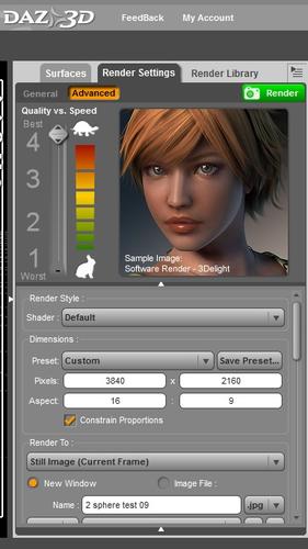

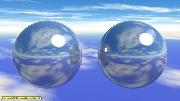

    Thanks to both of you for responding.
    Well it took some learning and fiddling around with DS, but hopefully the attached images will demonstrate my concern about the reset to box filter. Both renders were done with same setting. The progressive render engine reset the sinc filter to box as was discussed at the beginning of the discussion.
    Please see attached.
    955 x 535 - 357K
    955 x 535 - 355K
    1920 x 1080 - 315K
