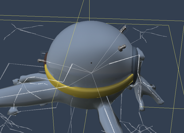

Another model and another problem with OBJ export from Carrara. Other than my poor modeling skills the mesh looks fine in Carrara, but export as OBJ with morph/skinning so as to retain the pose and re-import and the mesh is distorted. (I'm not doing this to import an OBJ into Carrara, that was just a check to see if the problem was importing the OBJ into Makerware or the exported mesh.)
The model was created and rigged in Carrara and so uses Carrara rigging. There was some minor cleanup where the wrong bones were assigned to vertices, and the "body" (which is where the distortion is) bone weights were adjusted at the belt and above to only take influence from the skeleton root.
Is this just a limitation in Carrara's OBJ support? Or am I doing something wrong?

    Something is going badly wrong between the rig and the smoothing. Export "un-smoothed", re import, smooth again, re-export.

    Well, I didn't but Fenric did. Thanks, Fenric!
    The creature may not be much, but now he can be printed in action poses.
