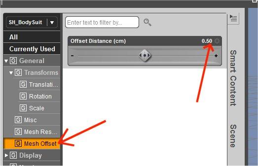

    A push modifier some times helps. When in the scene tap click to highlight the item that needs to fit better and click the button in the top corner of the scene window. Then Edit/Geometry/Apply Push Modifier then in the Parameters tab you will see you can set the amount, by default it goes to one between .30 to .50 seems to work best for me. RAMWolff showed it to me with the G2 supersuit and its fitting issues. Found in this thread http://www.daz3d.com/forums/discussion/25097/P15 THE EXAMPLE shows me highliting Genesis you would want to choose the clothing item.
    Oh wow. Thank you so very much! I did not know about this. Here is a quickie render applied to the socks and jacket. I did the other pose before because in order to get the socks to not show poke through I had to hide the legs which ended up hiding too much. If I was doing the invisible man it would have been fine but alas I was not. I applied what you showed and there you go. No poke through and no hiding. I had tried smoothing and collision all up and down the dial to no avail but this worked great. I'll put together a little tutorial for these and other ideas on poke through so I don't forget them. I'm getting older and the mind just isn't what it used to be.

  • SkelchSkelch Posts: 276
    Glad it helped, it has helped me so much since RAMWolff showed it to some of us in that other post, it took me a bit to figure out how to find what he was saying, that is why I used the screen shots, but once I got it it has helped me so much with a great deal of clothes.
