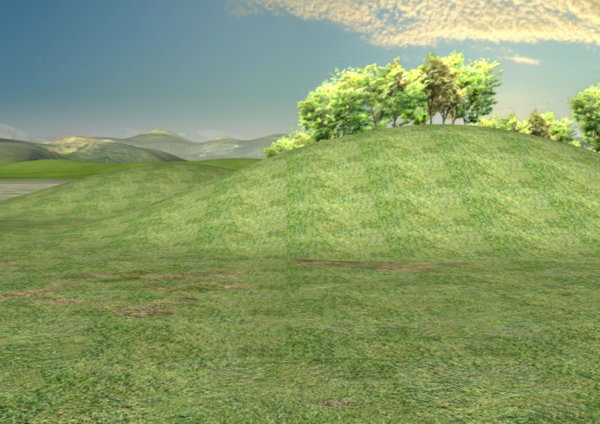

Just got this thing yesterday, and I seem to be running into an issue, which is turning trees into witches and making them fly (see screenshot). This happens when I turn on the Near-RollingHills morph. Not sure if this is intended and you're supposed to use the bajillion tree morphs to compensate.

I also have that issue until I figured out by using "soft slopes" it actually raises the ground like hills to match up with the floating trees (picture 1).
Edit: If you turn the camera slightly over the hill, you can clearly see the floating trees still (picture 2).

I'm not seeing the issue in Poser. I apply the morph, the trees move. On preview, the trees appear to float but when I render, the hills are visible with the trees on the hill.
Zenrel: I didn't spot the Soft Slopes morph earlier. It does help with distant renders, but I get the same issue you found, if I move over the hill, those trees are still flying around.
icprncss: I'm applying this via WB-Base in the scene tab > Parameters tab WorldBase > Ground-Hills > Near-RollingHills. Setting the Trees1&2 to Cntr helps (although now the floaters are behind the camera, which doesn't matter really lol). I guess I just need to adjust trees to compensate for the hills or lack thereof as necessary. In DS, the sliders aren't linked, so nothing else moves around when I use other sliders.

What I see in preview with Poser are the trees floating against the default background (the sky or hill textures are not visible on preview) after you apply the morph. After rendering, the sky and hill textures are visible and the trees are no longer floating.
I'm using DS so it's also happening here too.
Could be. Sounds like our viewports are the same, but I'm not getting a texture when rendered. What my render looks like above is exactly the same as my viewport.
