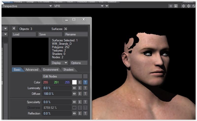

  • 0 out specular and make transparency 100%
  • wolf359wolf359 Posts: 3,955
    edited June 2018
    Hmm not working for me
    merely makes the hair dissapear.
    However thanks for the input nevertheless.
    800 x 491 - 79K
    Post edited by wolf359 on
  • AlienRendersAlienRenders Posts: 806
    You can use either the clip map or a texture in the transparency channel. Try using the transparency channel. You have to click on the T, set projection to UV, set UV Map to your object UV. For Image, select (load image) and load the same transparency image that's in your "Cutout Opacity" texture DAZ Studio for the same surface. Click "use texture'. You may have to copy the texture and smooth it out some. For rendering, in your light properties, set Shadow Type to Ray Trace. In Render Globals, turn on Ray Trace Shadows.
    https://www.lightwave3d.com/learn/article/transparency-map-tutorial-using-clip-maps/

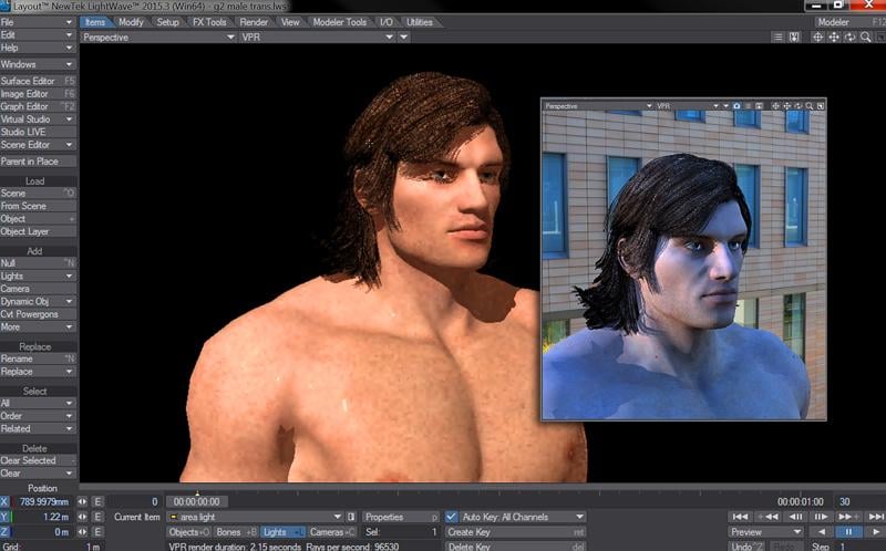

  • I rendered this in Lightwave today. I used transparency on the hair and some of the clothes. I also used clipmaps on the leaves in the tree and the ivy. Go to https://eraldegold.deviantart.com/art/Wishing-Well-749596307 to see what I did.

    Well I seem to have gotton it sorted
    Many thanks to @AlienRenders
    and @Grafx Studio
     For their kind assistance in chasing down what I was doing incorrectly.
    which primarily was combining diffuse and trans upon export from DS
     as well as not inverting the trans channel in the Lightwave surface editor. some refinements still needed however my migration from C4D
