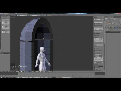

    I don't have or use Hexagon, but I could grab some screens or do a quick video of the process in Blender if that would help?
    Everything you do is helpful!
    Anything helps!  I haven't learned Hexagon, nor have I learned Blender yet.  So I am on an equal footing with both :)

    Okay, have a look at this!  You can download Blender for free here:
    https://www.blender.org/download/
    You may be thinking, looking at how long the video is, that I have an extremely poor grasp of the word "quick."  You are not wrong.
  • srinitysrinity Posts: 25
    Thank you SickleYield!  Everything else is ready, now to watch the video and make the alcove look good.
