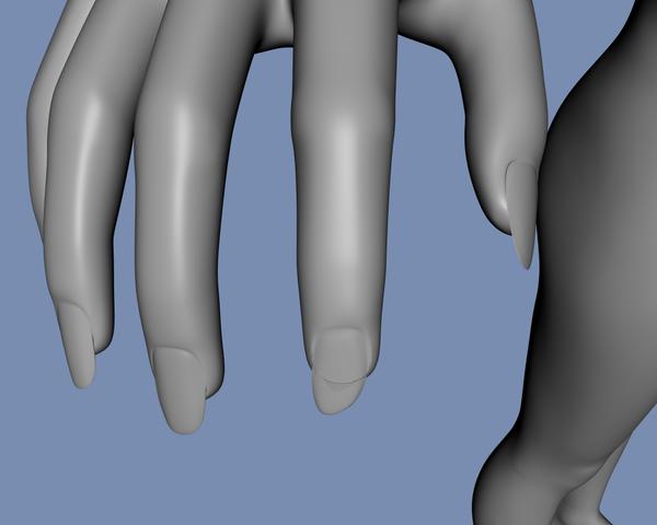

WHYYY do my girls' nails keep doing the following?
Okay yes I applied a V4 nail color just to see if it would work and these gre Genesis girls. But even when I go through the settings, load another Genesis character and copy over settings, check displacement, the works - they won't go back to normal and... I don't wanna build the scene from scratch over a nail. *sniffle*
Anybody got any ideas?
So far, displacement is at 0% where it was at like.. I dunno... not 100% but up there. Bump is norma. Hand textures are normal. I did manage to get some nails to get this black band on them when I copied over the Genesis default settings, but that's still a problem.
256 x 352 - 22K

    This is a render - the nails look fine in the viewport.
    I did think of bending the nails, but have no such animal. I lengthened them and the blank area remains in the same place When I copy over a genesis surface settings to these girls' hands, a black band appears over that blank spot.
    But a regular Genesis figure renders just fine. -_-

  • ghastlycomicghastlycomic Posts: 2,531
    Ah! That's one of the bug morphs of the Die Trying 182 morphs. The fingernail morph does that if you make them too long.
    I keep meaning to make a corrected fingernail morph. I've used fingernail morphs and I crank the 182 one just a tad to get it started and then go into Hexagon and pull the nails out longer with it so as to keep them from moving downward.

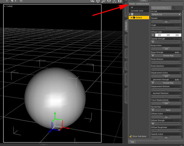

  • SzarkSzark Posts: 10,634
    When you click on a surface in the Surfaces Pane the name of the shader will show at the top of the pane.
    But if there are no displacement maps for the nails or fingers then yes probably down to Morphs.

  • spearcarrierspearcarrier Posts: 711
    Ah okay, then it would be the shaders under the shaders area. :-)

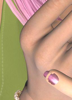

    It might just be that the morph defect shows up more with nail polish applied.
    1250 x 1000 - 247K
    Oh wow, I do see that!! I wonder why it does it. Wish I were good enough to fix it.
