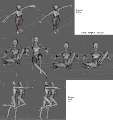

    OK, so I got it pretty close. The A3 shape for Genesis is a little off, so that makes it not as perfect. It's good enough for me, but you will still need a little adjustment. :0) The buttock/thigh combination also presents a challenge, as its not consistent, pose to pose, how those transfer.
    In any case, it make the pose on Genesis closer to the "intent" of the A3 pose, I think. There are some examples attached, which are also included in the download. Pics on the left are before, on the right are after. Thigh bends, abdomen and fingers are a large part of the changes.
    It's all clay color, so I think it's OK to post. (they are 2 of mattymanx poses, and default pose in the picture) In these examples, I did not make any additional adjustments.

    I've downloaded and have been able to play a little bit with your creation and have been happy with the results...although maybe not as you had intended. I don't have the A3 shape for Genesis so I just used a "raw" female figure and it still seems to work quite well. There are a few minor adjustments to make, mostly with the feet, but these are of a slight consideration insofar as I'm concerned. Thank you for putting this out in the community as it gives me a lot more options to use all these A3 poses I have with a whole new generation of figures. If I get a chance this weekend I'll try to post some of my results.
