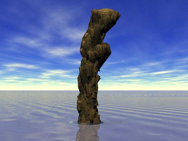

  • Rhian-SkybladeRhian-Skyblade Posts: 223
    edited July 2013
    I guess I need a lot practice :D
    Duh! damn time... need to buy more time flowers and slap those gray man for stealing it.
    Work calls
    1200 x 900 - 59K
    Post edited by Rhian-Skyblade on
    Work calls
    Looks to me like you're off to a great start.
    Really is a great start!

  • HeadwaxHeadwax Posts: 10,562
    Work calls
    excellent start, love the water around the base even
    Thanks for all the replies :)
    I will be experimenting for a while until I have what I want. Don't want too many polygons since my scenes always turn out very lush and detailed.
    Yes. The method I mentioned is actually intended to be very low poly. Big blocks with textures applied. The more I build with real stone and earth for people, the easier it becomes in 3d within Carrara. I doubt I'll find time within the next few weeks - but I will make some more examples for you - but I really like what you've made in such a short time. I really do. That's a keeper.
