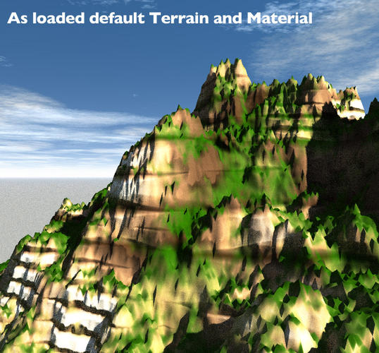

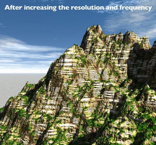

Here you go, these two pics show the difference by using the two methods I explained above.
