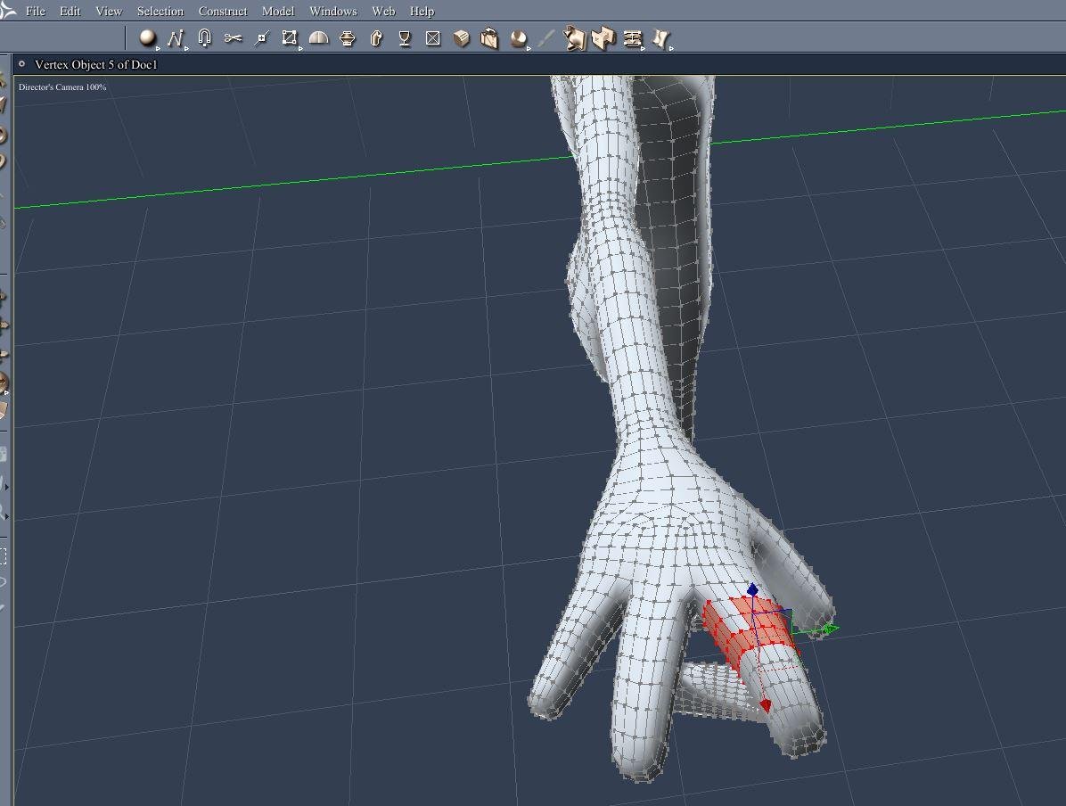

    Not only did I have the problems with missing joint rotations and missing comments described above, but Carrara randomly dropped polygons from named groups during successive saves.  In the attached picks, you can see 4 polygons dropped from the polygon group for rIndex1.  Overall, Carrara dropped about 150 polygons from assigned groups.  They seem to be randomly distributed.  Nothing in the mesh should have changed between these two saved versions.  The only changes were to skeleton bones.  sad  sad  sad    This seems to remind me of what foiled my attempts to use the softbody attach undersuits - Carrara kept forgetting polygons in the named groups for the undersuit.  sad
    1901 x 1052 - 198K
    1196 x 904 - 109K
    Post edited by Diomede on

    I went through each polygon group and added back the appropriate polygons.  Ouch.  But I was able to assign polygons to bones and do basic rigging in Studio, then bring the figure back to Carrara.
