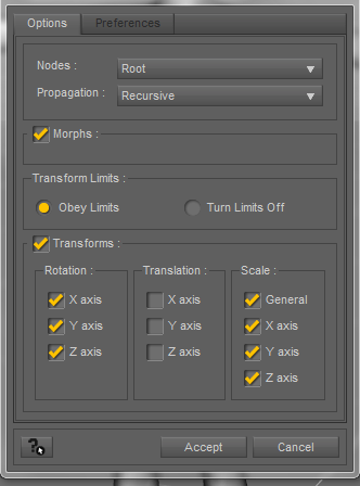

  • JaderailJaderail Posts: 0
    Hold down the CTRL key when you Apply the POSE, a pop up will open. Un-check Translate X,Y,Z and your done.
    332 x 448 - 22K
