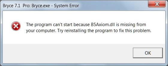

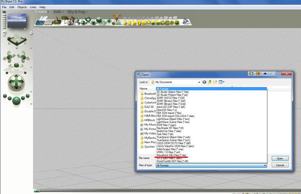

  • LearstangLearstang Posts: 46
    Attached are the error message I get when I first try to import an object, then the list of object files I can actually import. It's much smaller than the one in the other post here.

  • Dave SavageDave Savage Posts: 2,433
    Could you tell us what actual version of Bryce you're running?
    It should be 7.1.0.109
    Very strange because all versions of Bryce have been able to import .obj files. Right back to Bryce 2
    That's what it appears to be; I'm trying to re-install but running into some problems doing that! Strange indeed. Hopefully if I re-install, that will take care of it. I haven't had any problem importing .obj files until this version (I can still create them). Thanks all for the help!

    The missing .dll that it says it can't find is a Bryce 5 .dll
    Did you by chance install Br 7 on top of Bryce 5.
    Thank you Cris and all for the help! I've uninstalled everything, then re-installed Bryce and it imported an .obj file without any problems. If I have any further questions, I will post them here. Again, thank you all for the help!
