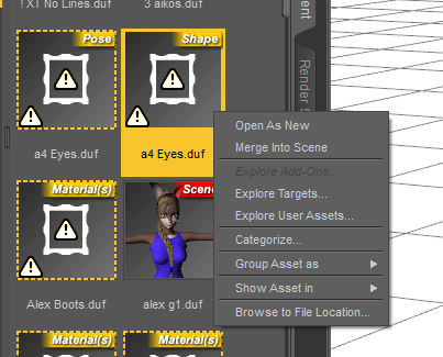

After my reinstall of my content I found a few random saved files missing, Well, I located them and they are exactly as nthey should be, in my xadian content, away from my main content. But now for some reaonI cant understand I have these esxlamation point saved files in smart content and I can't get rid of them .If I could actually see the expected path I could fix it but since there doesnt seem to be a way, and no way to delete them they sit. If I chose browse to location it does nothing. How can I find the expected path? I have no idea what to do about them, please help.

  • Richard HaseltineRichard Haseltine Posts: 111,786
    Where are the files and what are your content directories?

    they are where they always been, G:\! Custom DS\Xadian\Content\Runtime\libraries\Pose\!  Xadians\Character Settings There is no visible way to point out to Daz where the files are.
    You have G:\! Custom DS\Xadian\ set as a cntent directory, so you shouldn't have the folder named Content in the path - the Runtiem folder needs to be in the G:\! Custom DS\Xadian\ folder
    The Runtime is in G:\! Custom DS\Xadian\Content\, but the content directory is G:\! Custom DS\Xadian\ - the Runtime is in the wrong place in the content directory (it's in a sub-folder). Really, you don't want all those "Content" folders, they are just going to make it hard to see which content directory you are looking at inside DS since it shows only the last folder (which will usually be Content). Even if you didn't mind that, you certainly shouldn't have the folder holding the Content folder set as the DS format directory and the Content folder set as the Poser format directory.
    Where is the Daz Studio format content? Unless it's been placed in the Runtime or Data or Readme's folder it should show correctly.
    The folder that you select as a Content Directory can have any anme. It should be the folder that holds the Runtime and Data folders, among others. you should never have a folder selected as a content directory and a folder inside that selected as a content directory (which is one of the issues with having the Content folders selected).
    Is it actually being found, and loadable? If it's just in Lost and Found, and you have current metadata, then yes manual categorisation - however you do it - is the option. But you refer to having errors - !s - and that has nothing to do with not being categorised or being in Lost and Found.

    however, despite all this I am still finding some old saves with !. I really need to know why. The files havent moved, I only reinstalled all the data from scratch. I have no idea. It's mainly pose and shape presets that I can get back but still, I want to work out all the bugs before I really down to working on my comic to reduce the chance of a catastrophic bug. I double checked all the installs, making sure I had everything checked that I needed to be check, so I'm good there. Do you think a clean install would help? After saving my layout of course. (all of my appdata files are backed up in a copy)
    So presets that aren't showing are in a folder on disc with other content that does show? Can the presets be found as files under Daz Studio Formats?
  • XadeXade Posts: 236
    I cannot find it in smart content but I can find it under the daz formats and poser fomats. However, since I redid the content all the ! in my user files have vanished, but then again, so did the rest of them. The4y are still on my disk but I have to load them and save them before they appear.
    Have you reimported metadata? It sounds as if the database is initially empty.
    The importer should be able to merge the two.
    edited May 2018
    it seems to have worked, finally I havent found any more !s so far. And I can find most of my content in in the smart content. I'll do some research to see how to edit my own meta data to streamline stuff.
