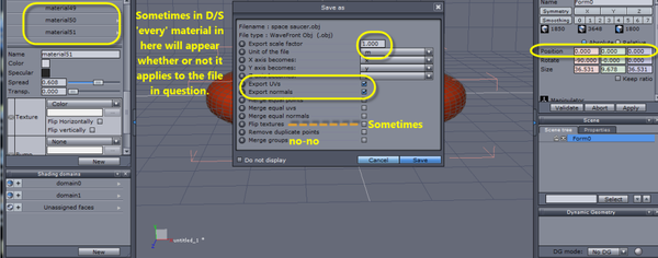

Export out the file, I know this works with the .obj files.

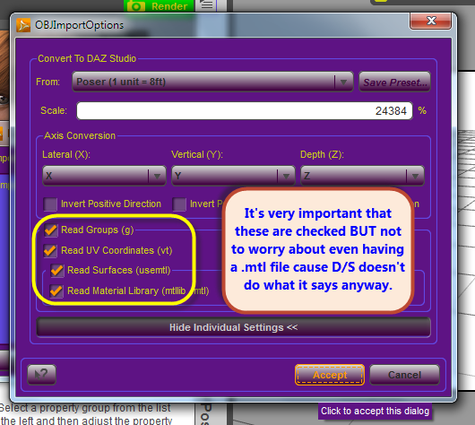

Import in the newly created .obj [or whatever] file.

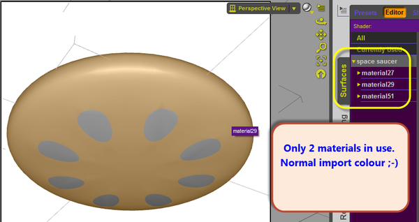

Make sure that the 'only' materials listed are those in use.

Export out the final .obj file.

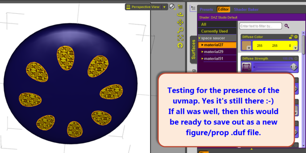

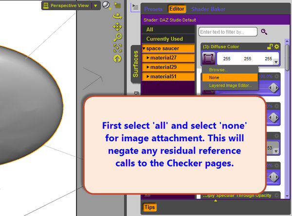

Import the file into D/S and from the Surface Tab, assign the colours and/or textures desired for each surface. Here you can apply the same colour to all of them if so desired. Save out your new prop or figure file and carry on.
