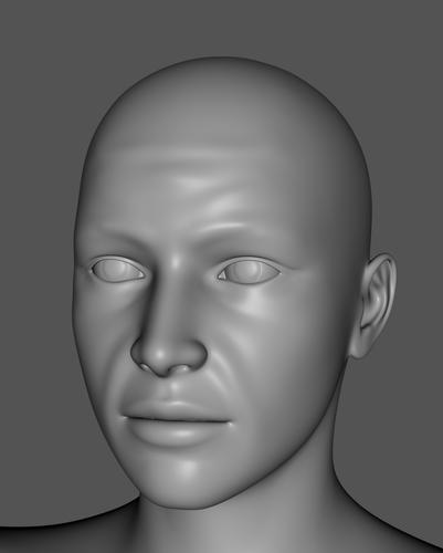

    Subdividing in ZBrush won't harm the Genesis mesh as long as you lower it back down to 1 before sending it back to DAZ Studio. I am speaking of using GoZ in this case, not sure if you wanted to go that route or not. To make sure before I posted, I gave it a try. I sent Genesis to ZBrush via GoZ, subdivided in ZBrush to Level 4 (1.2 million polys) and did some really crude modeling onto the mesh. Then, I lowered subd to level 1 and GoZ back to DAZ. I was given the option to create a morph for Genesis, which I did. Then applied the morph and raised Genesis' mesh resolution to 2, which was the max available for me. No problems at all.
    You won't get micro details transferred over, but in the case of my test, I got some good face wrinkles. One thing to try before porting back to DS is to go to the subtool menu while at level 1 and select the Project submenu, reproject higher subdivision. ZBrush will then go back to level 4, you lower it to level 1 again, then port to DS. Attached is a pic of my efforts, which could be better if this weren't just a test.

    @Slosh: That is almost exactly what I have been doing so far, but as you said some smaller details will not transfer over. It is those details that I am trying to get--certainly not at the skin pore level, but more so the larger sharp creases in areas like the armpits, gluts, and knees. I suppose it is not the end of the world, for I can always reimport the lowest level from DAZ and let ZBrush reproject the higher divisions; I just wanted to see some of those details in DAZ.
