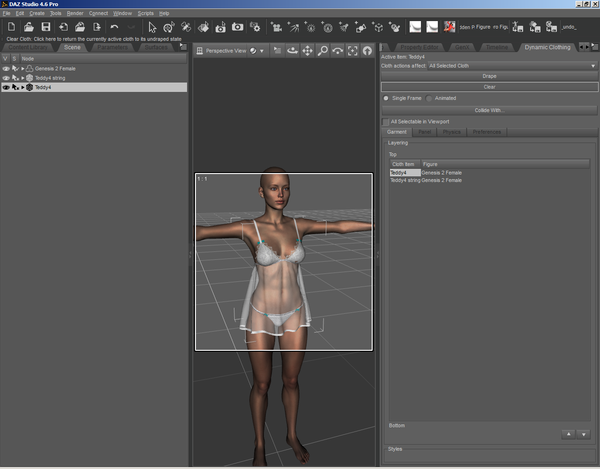

    Make sure you are selecting the Top level of the figure tree when using the All selected cloth option.
    Also, if you go to the Dynamic tab and change the "Cloth Actions Affect" drop down to "All cloth in scene", does the new stuff drape?

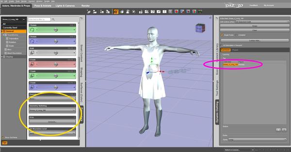

    This, combined with one of your other posts, makes me think that there's something wrong with your Content Management Service (CMS) installation.
    I don't have this particular clothing set, but I do have other recent dynamic releases. Dynamic clothing for V5 and V6 should Fit To the figure before you drape. According to your first image above, the item hasn't been, and therefore, it won't connect to the figure and you won't see it in the Cloth Item/Figure panel (the one that covers the bottom two thirds of the dynamic clothing control -- Garment Panel? No idea).
    Make sure Genesis/Genesis 2/V6 is selected before you put the item in the scene. If you don't see the item attached to the figure in the Garment Panel (both the name of the figure and the name of the clothing will appear), then use the "Fit To" option in Parameters to connect them together. Once that happens, draping should work. (See image below.)
    Unfortunately, I'm not at all qualified to help you troubleshoot your CMS; someone with more knowledge than I will need to work on that part.
