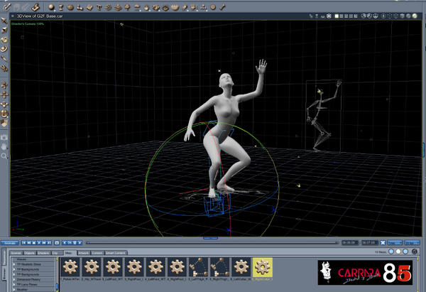

    I have them now! They are Right Here!
    Wow...
    Thank You (again!!!) Faba! You just continue to Rock my Animation World!!!
    And Thank You (again!!!) 3dage, for pointing this out!
    What a great setup. Here shown on the new Genesis 2 Female.
    Be sure to follow the instructions. Note that she wants you to put the Target Helpers onto the "Genesis" line, not the Hip, and Feet.
    The helpers (when done correctly) will appear at the bottom of the Genesis list - and work perfectly! :)
