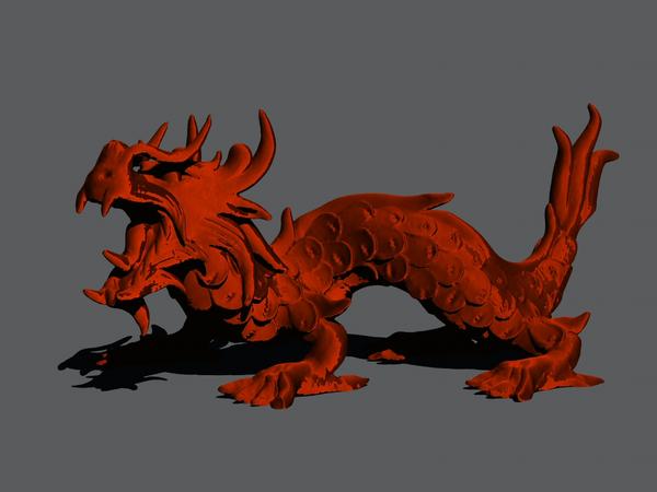

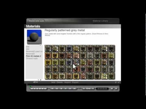

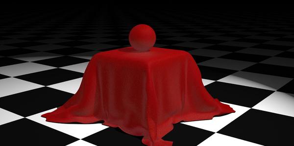

Yeah, I can do that. Bryce Made Easy - Velvet bump recipe - by David Brinnen
Edit.
Pros. Renders quickly.
Cons. Requires a bit of faffing in the DTE and needs to be applied to a fairly complex (high density) mesh object. Will not work well with low quality/low poly mesh objects.
I did this a while ago, following some of the suggestions of the good folks that hang out here.

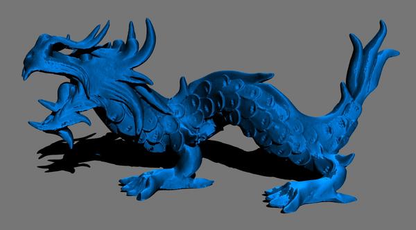

Yes indeed. In fact it is possible to make storybook grass as well with this effect. There are ways to super boost the effect to unnatural but cool looking levels. What you will also find is that objects with this material will affect one another. Two adjacent velvet objects will cast positive shadows onto one another multiplying the velvet effect in some areas in a cool but not truly accurate way. This Dome Light trick gets us close, but not fully there. Still it is one of the coolest effects I have in my arsenal. The example uploaded by Rareth was made with the velvet tutorial above. This lends itself well to crushed velvet, just play with the bump settings.
David's method looks great as well. What I like about it is that it doesn't rely on lights as such to produce the effect but rather the material does it alone. Fewer lights usually means faster rendering which is always a plus. To me David's example looks a lot like a crushed velvet already, or at least a rather heavy satin. My only concern is that David's approach might require a fixed camera perspective, which was the case previously but maybe he's solved that, I'm not sure as I haven't caught up on the latest videos. My approach can be viewed from any angle without issue..but because it requires light domes there can be banding issues so neither approach is free from considerations. It is good to see there is more than one way of doing this. I've not had the opportunity to test out David's velvet so I cannot say which approach gives the most accurate result. But in this case I dont think accuracy is really important, just the overall impression needs to be in the ball park. You can't go wrong either way.
