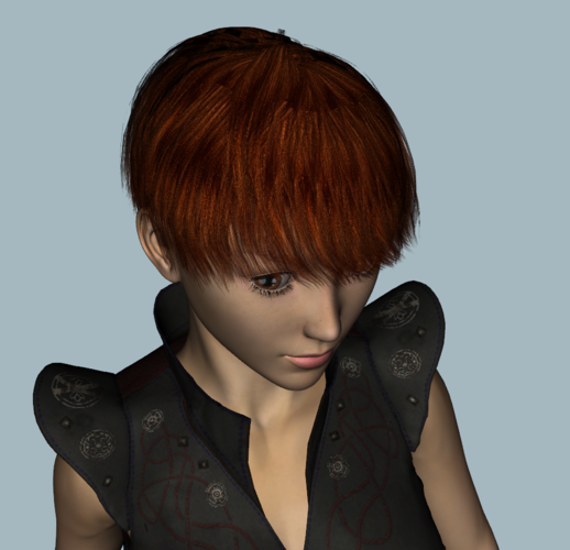

    I hope the picture shows up, but here is a sample I rendered. As you can see edges are pixelated, which I want to remove.
    1036 x 828 - 251K

    What are your render settings? It looks like you're using one of the OpenGL render settings (1, 2 or 3 on the slider in the render setting panel) Those are really only good for doing test renders to check your lighting and such.
    Here are 2 that I did trying to duplicate your issue. The first is on the fastest render (quality 1) setting - it's still not as jagged around the edges as yours but you can see some jaggies.
    The second is done with the default settings on quality 4 and it's much smoother.
    These were done with no real lighting and no camera so they can be much improved.
    950 x 917 - 697K
    950 x 917 - 777K

    Another trick you can try is to lower the Shade Rate in the Render settings window, the default is set a little high to allow for quicker renders but if you lower it to between .2 and .5 edges smooth, textures are crisper and it gives a nice overall render.
