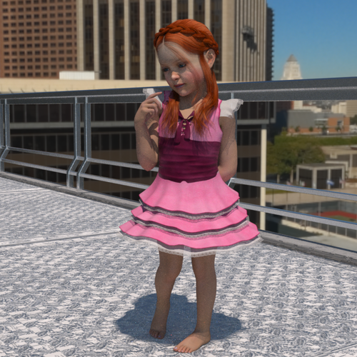

    I have another question, how do i catch shadows under my car??? If I want to use the IBL as background??

    A.B.A said:
    Thanks a lot for the answers. And great IBL's :)
    Shadow catchers don't work in Luxrender because it requires actual geometry. It's not recommended to use the IBL's as full backgrounds for this reason, but more as an addition to existing terrain to add skies or other useful articles.

  • SandmanGFXSandmanGFX Posts: 75
    I'd photoshop two renders together. One using the IBL, the other one using the shadow catcher. Experiment with the blending options. Usually I'd cut the model (car in your case) out of the shadow catcher's image as much as necessary, but it might not be necessary. You could get some nice results, purely by changing the blend options.
    The shadow catcher tutorial should still be out there I'm guessing.
    If you have Photoshop it's quite easy to cut out the car image using the selection tools. Make two 3DL renders. One with the shadows on, and one without, and using the same camera angle as the Luxus render. Using Photoshop, CTRL-select the layer with only the car on it and save the selection, then load the selection onto the shadowcatcher render. Hit delete and you'll remove the car from the image and be left with only the shadows.
    You can then overlay the shadows on your Luxus render.
