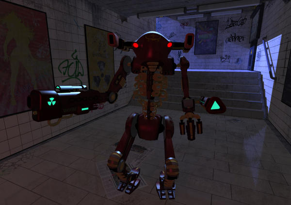

This is my first real render with Carrara, I bought it almost a year ago, played with it a bit, got really frustrated and left it. Now I have lots of time on my hands and want to do some Sci-Fi artwork.
Today I worked out how to get two models in the scene add two lights and position them and render the scene so it looks sort of OK.
Any comments are welcome.

    Next thing is to work out the surfaces and why the psiMan isn't casting a shadow.

    Made lots of changes and had a tinker in the Texture Room. Some things worked out and others didn't.
    I still cant work out how to get shadows for the psiman without ruining the lighting I have. I also can't work out why there seems to be light in the scene when all the lights are turned off, I thought with no lights the scene would render black but there is an ambient glow and I don't know where it's coming from.

    Hi Steve, great you are enjoying yourself.
    In Carrara ambient lighting is set at 20 percent by default - just to annoy us.
    In the instances list see where it says Scene ? (instances list is that list at middle to bottom right that shows what is in your scene, click on the word "Scene, then up the top you will see some new windos at top right , One of them will habe the ambient setting in it - drag the thingy all the way to the left.
    If you cant get shaddows on your robot still, make all the lights invisable, then drop a bulb really close to the robot on the right and see what happens - If no shadows, maybe he is floating off the floor, maybe he has his shadows turned off. Maybe you have shadows turned off in the render room though the light at the back indicates this is not the case?
    Nice r enders by the way.
    HINt to get your light to be close to the robot, select robot, hold down shift key and select light, then use ctrl k and this will bring up the align tool

    Thank you so much head wax, that has really helped me out. With the ambient gone the scene is as dark as I thought it should and I can see faint shadows from psiman on the floor now. It also gives me a lot of headroom with the lighting.
    I will also try your tip for aligning objects.

    To touch on the shadow issue a bit:
    For the light, you can adjust the shadow intensity. If you've turned that down, then it can be washed out more easily. Another possibility is Raytraced Soft Shadows which are located under the light's effects tab. When enabled, the higher the light radius (think hundreds of feet) can make the shadow more diffuse and can blend it in to the environment, making it harder to see.
    The first image you posted looked as if you had enabled Indirect Light. With the right lighting it can also cause your shadows to become more diffuse. Especially if there isn't a light shining directly on the model, in which case whatever shadow is created would be created with lower intensity reflected light, which would also mean the shadow could get washed out easier.
    I also forgot:
    You mentioned the ability to exclude and include objects to light. If you have a light only shining on the robot and excluding all other objects, that could account for not seeing a shadow from that light.

    Thanks for all the tips evilproducer, I did have Indirect Light on with the lighting quality set to excellent in the first one, also the front light was set to illuminate the figure only because the spill made the background to bright. Also thanks for pointing out the effects tab, I hadn't noticed it yet, now I've got another cool feature to play with.
