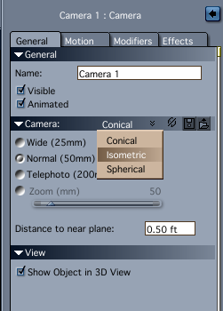

Any suggestions? would be nice if it worked with the Isometric camera as well.

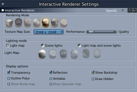

    Have you tried going into your interactive renderer settings (circled arrow - upper right) and setting "Show Backdrop"?
    This only works in the directors camera. So you go into Directors camera and go "Set Position to" and select the camera you wish to render to.

    Dart is the closest to what you want based on the description in your original post.
    You need to load the image in the backdrop, go to the interactive render settings which is the up arrow with a circle around it at the top right of your window. Once the control panel opens, enable the Show Backdrop checkbox. Click okay. Whatever image, whether it be a still image, animation or image sequence will appear in your camera view.
    To render the animation without the backdrop showing, in the Render room, under File Format, choose a format that supports alpha channels and then enable the Render Alpha Channel checkbox. I've had better results for compositing if I leave the Pre-multiply option disabled.
    If you're rendering to an image sequence, pngs work well with alphas and it's a lossless format. For video codecs, I prefer Quicktime's Animation codec.
    The aspect of the image/video used as a backdrop should be the same as your final render to avoid distortion. You should also have no problem using an isometric camera as long as the aspect ratio is the same as the backdrop.
