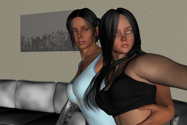

  • jstiltonjstilton Posts: 134
    edited October 2014
    here is an example
    the left figure is olympia, whose eyes are ok
    the right figure is vic 6, and the white of her eyes is too white
    any suggestions as to how i can change that are welcome
    thanks!
    1710 x 1140 - 724K
    Post edited by jstilton on
  • BlackFeather1973BlackFeather1973 Posts: 739
    here is an example
    thanks!
    Ah yes, i see what you meant now.
    The standard texture on V6 has the AoA_Subsurface shader. Depending on your lighting and render settings this can cause the texture to glow. The quick fix for the eyes would be to go into the Surfaces-tab and set the "Subsurface Off-On" setting to zero for both the 'Sclera' and the 'Irises" surfaces.
    thanks for your answer blackfeather. i just tried it and it looked good, but then i tried with the original subsurface settings, and it looked the same, so now i'm confused :-) i must have changed some other settings too. in any case i will remember this for when i see the very white eyes again
