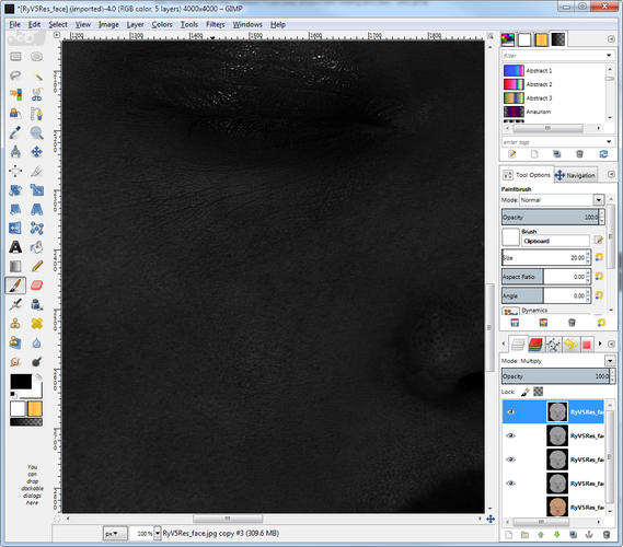

    Try this in Gimp to at least give you a starting point. Since buying Photoshop, the last Gimp version I have is 2.8 and I don't think I had any plugins so what I used should be available to you.
    Open your skin, duplicate the layer and hide the original. Go to Colors > Colorify > Set it to white to give you a desaturated map. Duplicate that layer, and set the new layer to Multiply. Duplicate the Multiply layer 2-3 times and you should get something similar. You will have to add in your highlights on the lips/eyes and such.
    It may not be the best method, but it's the closest I've been able to come by looking at spec maps that were included with some of the characters I've bought.
    I do, however, also have products with spec maps that are as light as the result from just a simple desaturation without any darkening of the map. You just have to figure out what works best for your figure.
    I've also editing my initial post where I used the term 'greyscale'. Desaturation is a better term as you don't actually convert from RGB.
